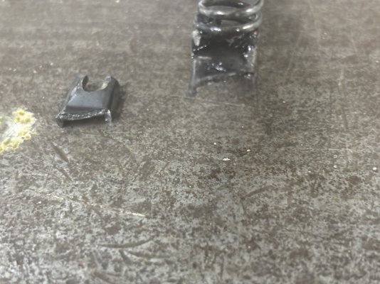

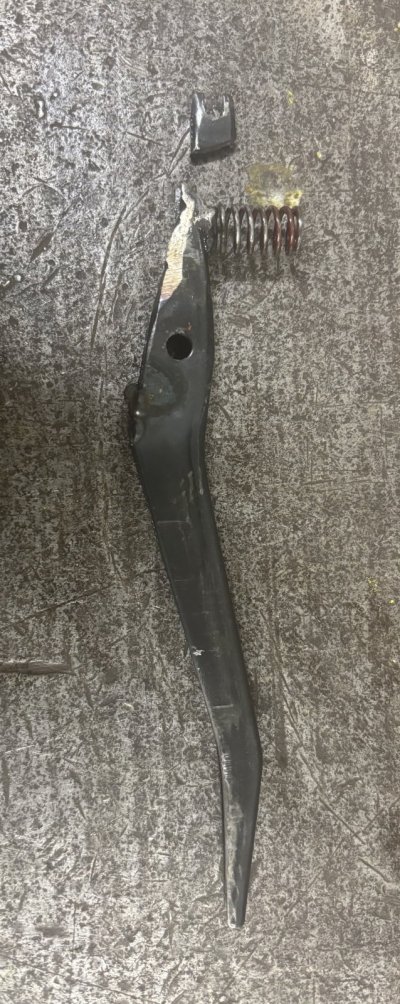

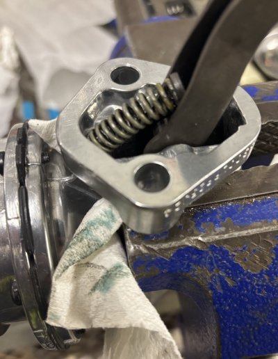

After about a thousand miles the pump arm broke. Looks like it’s from the constant pressure it was under as the arm was pressed against the cam lobe more than I liked were it would always be pulling the diaphragm up and never let it go down all the way.

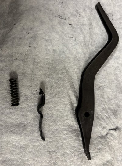

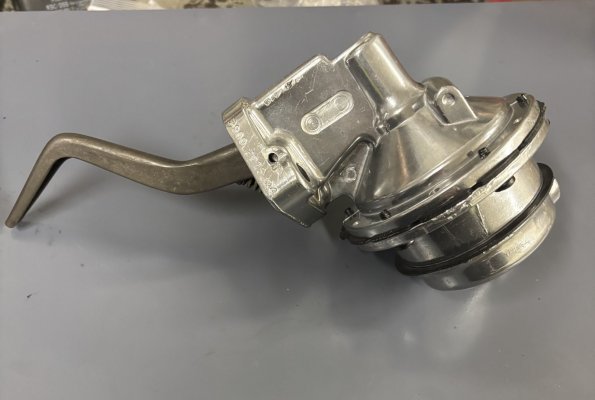

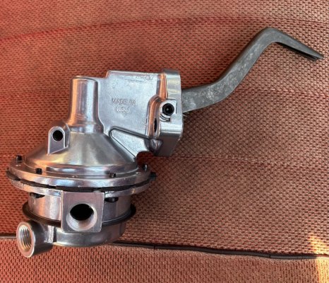

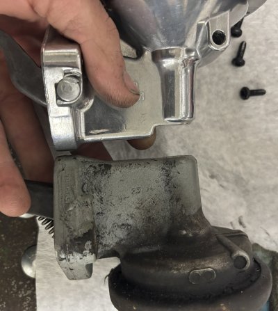

But on a better note found out that the original pump arm fits perfectly in the Big block pump housing with no modifications to the pump arm. Ended up drilling and taping the ends for set screws just in case the pin tries to move around shouldn’t as it’s pressed in there pretty good.

So if I understand correctly you can just remove the arm from a pump that fits the IDI and fit it to the big block pump as is ?

Hopefully it is a direct duplicate of the arm design inside of the new pump.:dunno
As long as the part from the idi arms pivot pin to inside the new pump matches the pump and original arm, in all dimensions AND the part from mounting flange inside the eng. Matches the idi internally.
That would be a winner.
