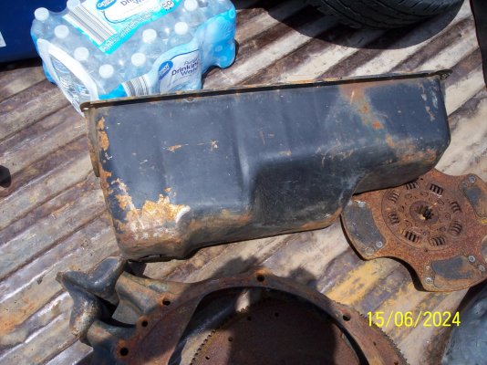

I will need to fabricate a different oil pan with 12+ quart oil capacity.
International applications used two different types of oil pans. I believe that one is a 14 Qt. pan? Both styles are a front sump design though.
This is a picture of what I believe to be the smaller capacity International oil pan just for reference.
Front sump is OK as the engine will be installed with the flywheel facing forward.
A cardan shaft will then connect from the flywheel to the inboard v-drive transmission that will drive a conventional shaft / propeller.
I may still chose to fabricate a pan from aluminum to better withstand the effects of salt water corrosion.
