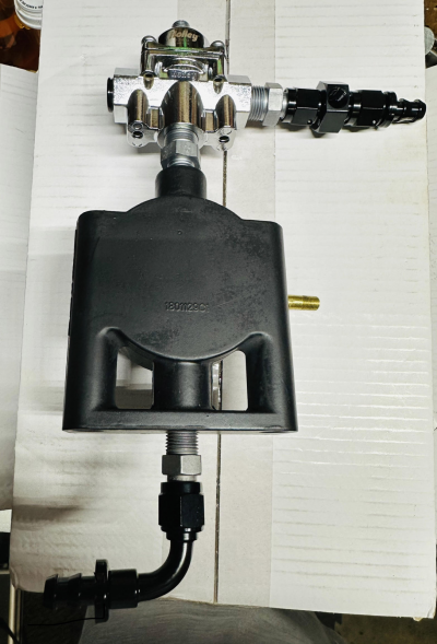

I have gathered all my fuel components including a new gas tank. Ready to install and in set up I noticed I can place the fuel regulator straight into the filter head , followed by pressure gauge and then into IP....but the regulator will be horizontally place with adjustment screw towards the fire wall - any one have a comment as to if this being a problem with the regulator fucntion??? does it have to be stright up (adjustment screw upwards) to be best?
Holley regulator 12-803 4.5 to 9psi

You might have issues with too much vibration by doing that. The vibrations may end up breaking the regulator. I don't know either way, but it's a possibility.

PIC of the set up from inline fuel from Epump through filter
/housing, out to reg, to pressure gauge and onto the line to IP - did not think about the VIBRA! Would it be best to get a 90deg fitting to point the reg vertical? or still to much VIBRA?
