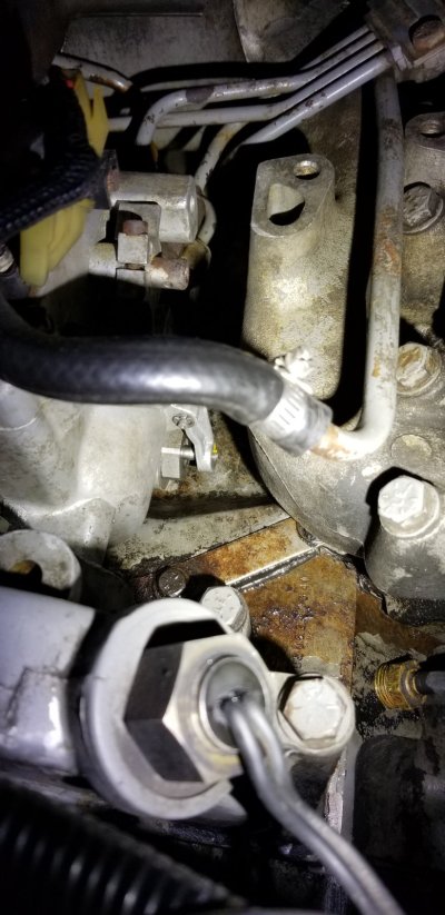

Hello to all. I just recently picked up an 89 f350 Dually 7.3 zf5. I have fixed most of the major issues that kept it from being driveable, but I am struggling with a diesel leak.

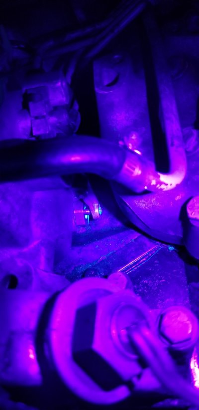

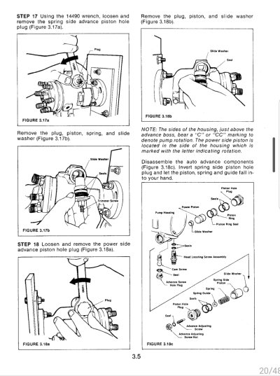

I put uv dye in the fuel filter and found that the advance piston seal was leaking. I cut off a 1" wrench and pulled out the large hex (piston hole plug) and the small pin (manual calls this adjusting screw though mine is adjusted on the rocker arm). I replaced the o ring that goes around piston hole plug and the small lip seal that goes around shaft. It seemed to fix it at first but after running some errands I discovered that is still leaking.
It only leaks under load, not revving or idling in the driveway, hence the need for uv dye.
what should I do next?
Can I remove all of the parts of this and replace the seals while it is still in truck?
Please give me some idea how to proceed. Thank you.

Did you feel how well that seal fit on the pin? I assume it is leaking on the id of the seal, or is ot leaking around the od?
ArminTamzarian
Jul 4, 2026
Washington, not DC
It was much tighter on the shaft after replacing the seal. It is leaking around the pin. The UV dye is visible around the pin. I haven't ever seen it leak, but I did clean the dye off when I changed the seal. The attached photo is after changing the seal.
