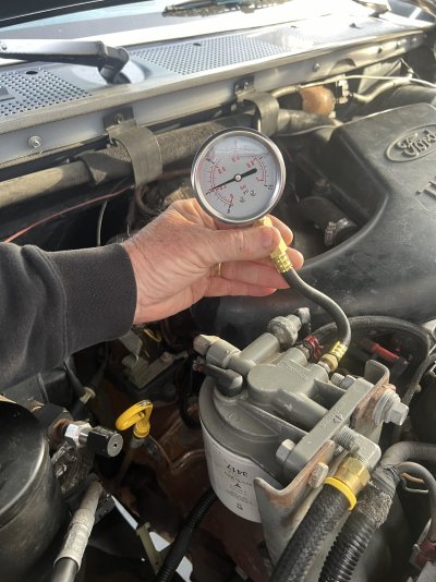

Pulled the front sender/fuel pickup and it was clean as a whistle. Not even a spec of crud to be found. Replaced the shower head (that was fine as far as I could tell), the gasket and lock ring.
Next I pulled the fuel selector valve after some rather long winded sessions of werewolfing 4 letter explicatives. It had a bit of crud down in each of the ports when I sampled with some q-tips, but it was working fine. I cleaned it all up with some citrus degreaser and screwed it back together. I blew out the line from the fsv to the lift pump and all the fuel came out clean as whistle there too.

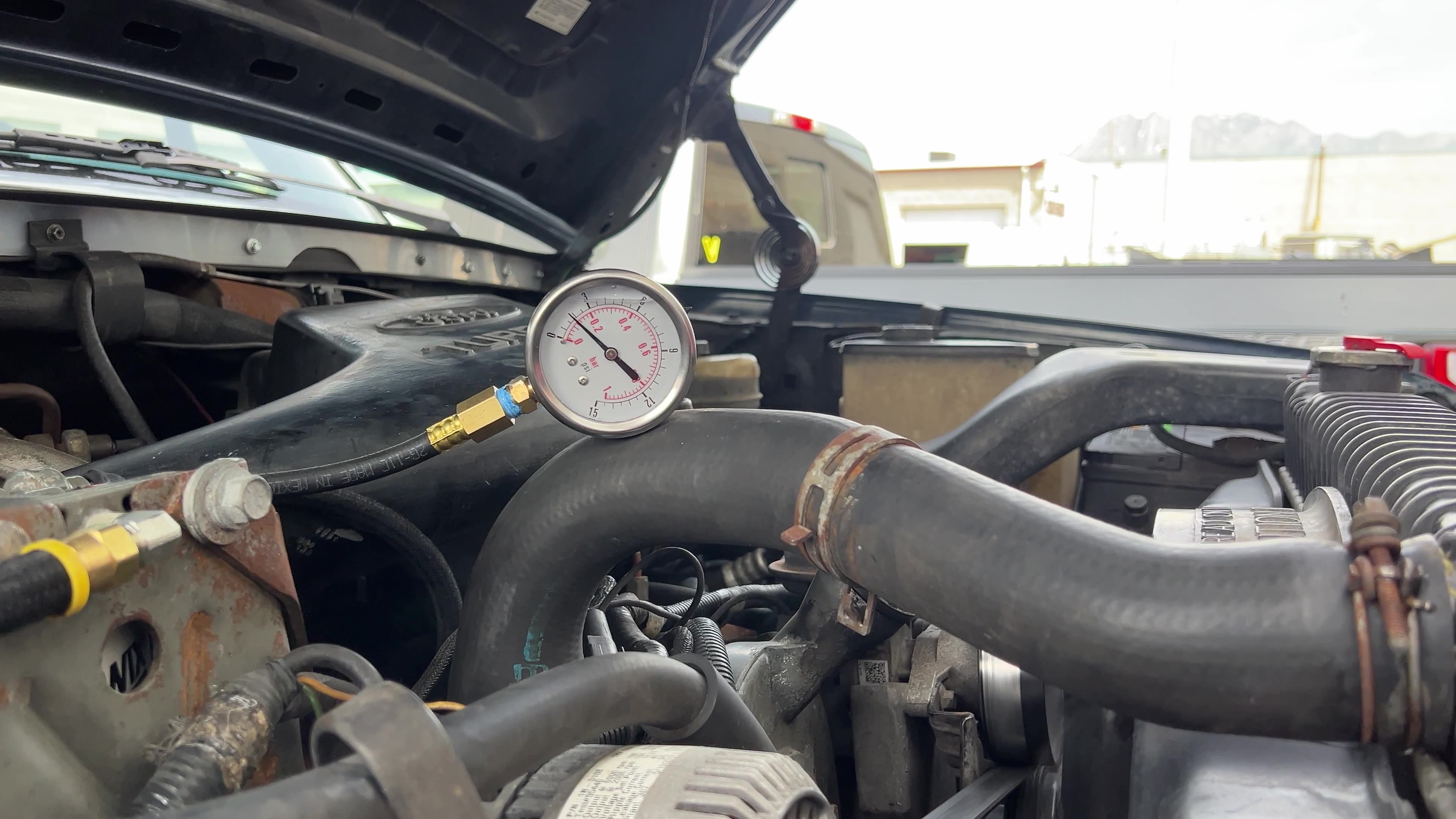

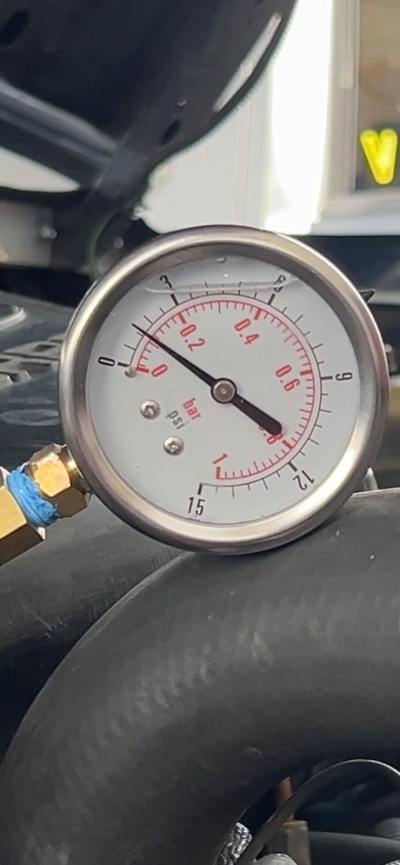

Got it all back together and now I'm getting 3-6.5 psi after the filter when idling and no load revs. I guess that was worth the work, but...
...it didn't fix my no power above idle problem that has me down this rabbit hole in the first place. Perfect starting, smooth idle and just nothing when you stomp on it. Revs to 2800, but no black smoke no matter how hard I try to roll coal.

I switched an an electric pump (Walbro) and found that it cycled a lot (pulse rate seemed high). I found that the filter head vent (return line) was bypassing a lot of fuel so I pinched it. You can greatly reduce the fuel flow though the return line, theoretically increasing your supply pressure.
In fact, I tried blocking the filter head return completely and didn't have any issues. In my case, the e-pump cycle went from maybe two per second to less than one every two seconds. I think the only point of the filter head return is to vent any air intrusion from the supply, so if your suction lines are good then it serves no purpose. As a compromise I just restricted this line.
Just try it with a pair of vice grips and see how your feed pressure responds.
Oh, will go give that a try right now !!!
Thanks
EDIT: Update... Nope, that didn't change anything. Thanks though.

I had an idi that didn't like pressure over around 3-3.5 psi. it lost all top end power at 5-6psi. pedal to the floor would barely get to 55. i had installed a holly red because the mechanical pump was weeping to the ground. it was on an Econoline and getting to the pump was harder due to how the engine is mounted. i had to add a dial style pressure regulator to reduce the pressure. it did the trick, had no problems at all after that. the regulator was before the stock fuel filter.

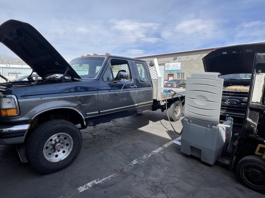

Figured I'd finish this one out. Got the rebuilt IP in and timed last Thurs. Been noodling around with it for a couple days and a cold start this morning at about 40 deg F it hit on about third rotation with virtually zero smoke and runs like a top.
I now need to be a tender foot to keep from rolling coal in the lower rpm ranges, but it all seems to be zooming.
