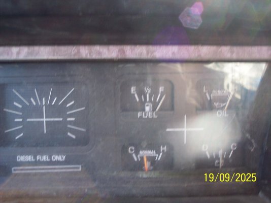

I did all of this too. I used a Carter 4010 because they're relatively cheap. They aren't as good as they used to be, but they don't run very long at one time. I also don't worry much about the rear tank fuel level. If I have any doubts, or if it's been long enough that I can't remember, I just fill the rear tank. There is the possibility of overfilling the front tank this way, but I've only done that once. That was after a night of two hours of sleep, all day driving, temps in the lower 90s, and higher humidity than I'm used to most of the year. I was almost falling asleep and I just, plain forgot about it. I have no idea how long the fuel trail was behind me. Good thing that I was in rural Oklahoma when it happened! My lighted toggle switch didn't help that day. Normally, I see the light and won't forget. It's kind of tricky with my fuel gauge too. It will go WAY over full so if I shut it off at full, I won't get a full tank. I was going to suggest carrying a spare e pump, but you seem to have that covered. The picture below is of my fuel gauge when the front tank's about full. It's kind of blurry because I was driving when I took it. I had to because it's the only time that I see the gauge that high.
