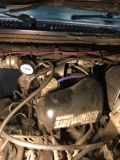

There are two 1/8 npt plugs in the main oil gallery, driver side, the rear one is often used for oil to the turbo if one is added (like my truck). the other is further forward on the same horizontal line from the rear one. Both plugs provide access to the main oil gallery which should be pressurized in normal operation. In my case, the rear plug is used for oil to the Banks turbo, the front is plumbed with 1/8 copper tube to the relocated oil pressure sender unit which also has a mechanical gauge so I can check real oil pressure when in doubt.
