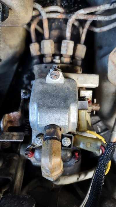

Hello experts,
1986 F250, 6.9 IDI, mostly factory config.
Got sudden no start condition which I diagnosed to likely shut off valve issue (my steps are below if you want long reading).
Without removing IP lid - there is 12 V on solenoid when key is on. Solenoid the resistance is about 4 Ohms. When I disconnect and connect red wire connector there is faint click.
Since it is likely the shut off solenoid isn't fully working after 40 years of service, which vendor is recommended to order shut off solenoid from ? To avoid common low quality part common these days.
Also, there are (factory?) seals on screws holding the lid (photo). Do I need to take note of something before breaking the seals on these three bolts ?
Thanks
Sergey

Those are just tamper marks to tell if the cover has been removed but not important unless your warranty is still in effect, but those ford 40+ year warranties will really hit you in the pocket book. If you do open the cover be sure to go read some of the tech articles on issues to watch for. If re-installed incorrectly it can cause a run away as it will hold the fuel shutoff opened and shutting off the key wont stop it at that point. It is not difficult but just be aware. Besides that I would guess that if it is clicking it is probably working as intended, the click isn't that loud when operating normally
