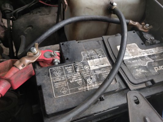

Here's a picture of my cables. I just cut the old ends off and...... well..... just look at the picture, you'll figure it out.
I do fence work sometimes and the crimpers that you can buy tractor supply for doing high tensile wire make the crimp you see on my lugs. I load them up with dielectric grease and squeeze away!

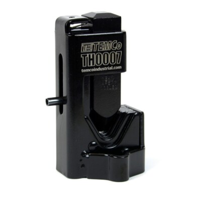

heavy duty Crimper from West Marine for $295, is $25 on this site.
Lordy...if they are both the same thing or comparable quality then I would chance a few bucks and try one out...
I should have gotten the name of the manufacturer of the big one I used to use...have not found it...but it would have been great if you use it frequently...
You sure seem talented in finding stuff...all I can do is just take a stab at it...just don't have the time or patience.
I could use a good crimper...thanks for the input.

This link is from old goat's post for the crimper...
It was a little uninformative as to what dies shipped with it... A kit? Only one?
Well, there is a "choose size" selector. So I did.
Well, after that, I came to the notion that those people may not know what a crimper is used for...
Possible explanation...some business used an AI to prepare their web site...and to it, a crimper is a shoe? And it certainly hasn't ever used one, so how would it know?

It`s the same part# XOLATUM posted above
with West Marine.
I bet the real expensive one and the cheaper $25 one probably all made China.

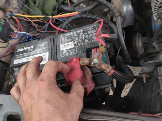

End of this chapter --- bought & installed the made-up NAPA positive cable for this truck -- the cable between the 2 batteries was a 2/0 (so was the portion running to the starter) and was a little too long -- turned the drivers battery to where pos pole was on the outside -- worked great.
Peeled back the insulation near the terminals and there was heavy green stuff on the inside of the cables -- the wires themselves were in pretty good shape -- just that surface corrosion, but do think it continued into the terminal itself.
Did have to re-use the trigger wire from the starter relay -- PITA getting it out of the cable protector & the cable holder attached to the block.
