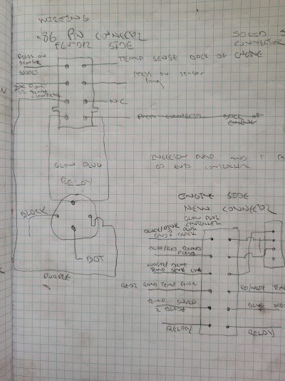

In case anyone else is looking for this, I wired in new glow plug controller using new connector. I mapped the pins from the old connector to the new connector. Hopefully this is sufficient. Will attempt to fire up the truck soon, so I can confirm it works, but I mapped the pins from old and new connectors as follows (sorry if my handwriting sucks). One thing to note is that the diarams are looking down at the pins (connection side) and that the old connector is from fender side perspective and new is from engine side (pins swapped right to left when converting to fender side). Here's a pic. Probably a dumb question, but I don't know so I'm going to ask. The ignition on wire that goes to temp sense and cold start and low idle on the injection pump is thin. On the new style, they have two fused thicker wires becuase it also feeds the fuel warmer tube. Is the hot side of the starter relay always hot, or is it only hot when ignition is on? Curious if I can feed the blue wires with this.
12,322
11,036
The hot side of the starter relay/solenoid is connected directly to your passenger's battery. It's always hot. The other side is only hot when the key is in the "start" position, but I'm sure that you already knew that last part.
