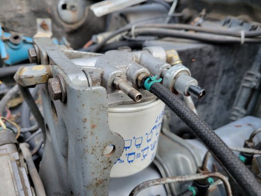

Going through and fixing leaks till I try it again. I have new filter bracket with sender. Sender is leaking bad. Is that stock sender and gauge for late model trucks? Does it fit any aftermarket gauges? Can I get after market gauge/sender that will fit these threads?

I'm pretty sure that is what lights up the "Fuel Filter" light on 7,3 trucks. You can remove that sender and put a 1/8 NPT (I think) plug in it's place and be just fine. It's also a good spot to hook up a fuel pressure gauge if you wanted one.

Fuel gauge it is. Need to do some research and figure out a good brand and how to connect and survive engine vibration (maybe some type of quick disconnect like an air hose).

Got a cheap gauge and a plug at napa. One of the plastic caps was leaking so fixed (replaced) that with another I had laying around. Having the fuel guage and knowing that's what the input of the injection pump is seeing is great. Now I know the injection pump is getting 3 to 4 lbs of pressure. Got fuel to the cracked injector injector lines. Pretty happy about that. Swapped out the broken glow plug controller with no ground with one that had a ground. Had to swap out one of the back intake bolds, as I didn't put one in with a nipple for the ground and harness bracket. Just had a bolt before. Torqued to 24 ft/lbs. Figure its fine, but probably not great to torque everything, remove a bolt and put one back in an re-torque. Maybe no big deal, but wished I had put the right bolt in there to start.
Got the zf-5 shifter in. Feels loose. I can't remember if the ball end sits in a plastic cup or something. No plastic in mine, but there is some slop.
Going back to the gauge. I'll likely keep it connected while I'm starting it up, or if I have problems, but keep the plug in there most of the time. I've heard the gauges won't survive the vibration and end up breaking if you try to leave them in.

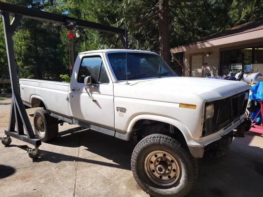

Got some time to work on the truck and get driveline to the driveline shop. Got measurements for driveline so shop will start on then next week. New senders came and went in last week. Resistance looks good but gages still read read empty. Going to fill it up and see if they move. They only have around 4 gallons (each) in them now but guages didn't move. Put the bed back on cause it looks better than a tarp and I know senders, floats and showerheads are good. Also put the hood on so I don't need a tarp there too. Might make some things harder but looks cleaner and gets some of the parts I had laying around the yard cleaned up. Truck looks better too. Still a ton of work to do but looks like a truck again.
