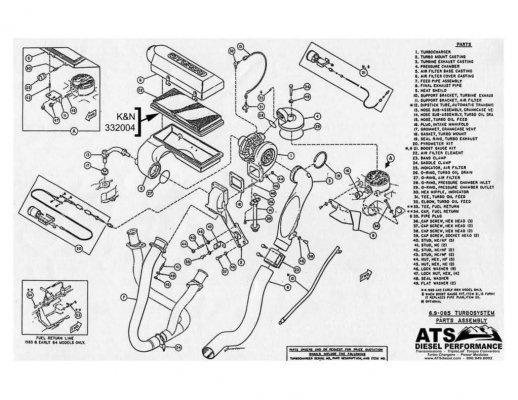

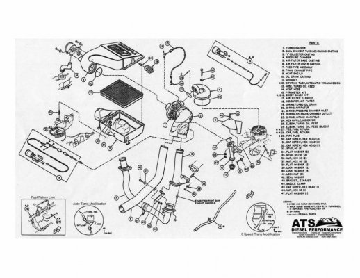

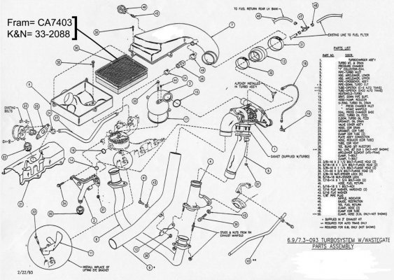

I've attached the three older style of ATS turbo kits. The last version of "Aurora" ATS kit was basically the same as the 093 version, but with an upgraded turbocharger. I've disconnected the wastegate on my 093 setup and it can reach about 14.5 PSI on a good day. I used to run the 088 (still have most of it in storage) and it wasn't as good in my opinion but anything is better than N/A. Boost on the 093 is better across the range but low end was most noticeable.
