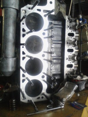

I have used Hylomar with great results, Originally I had an oil leak on a 351W with Cometic multi layered head gasket that I could not solve, a can of Hylomar and problem solved.
So I now keep a can for any performance application I am faced with fixing...
