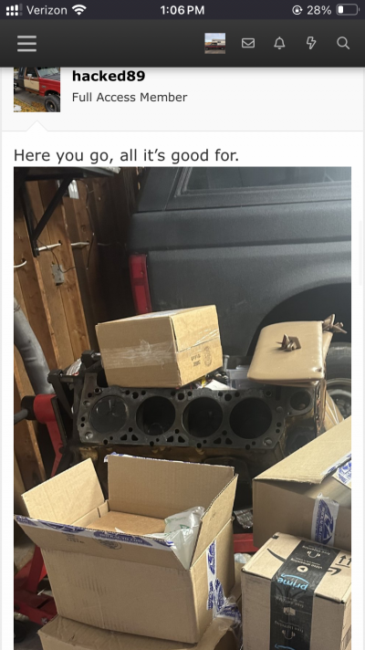

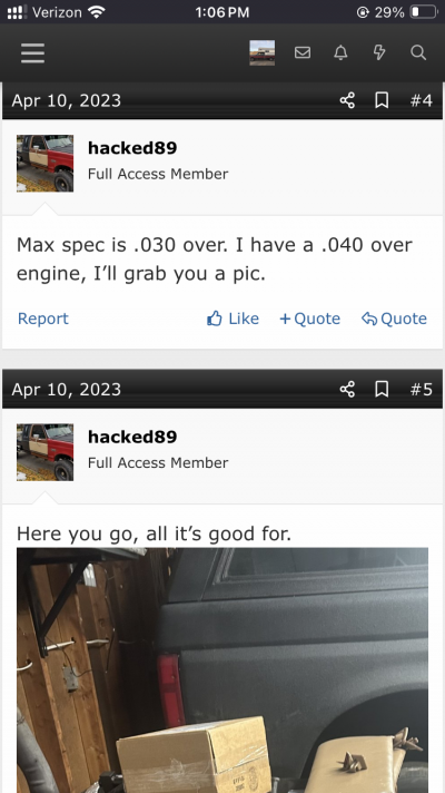

You can but max spec is .03” per other members
Thanks for the info. But you definitely don't have to worry about going .010" or .020 over. The person I was replying to was trying to act like any kind of boring on the cylinder wall was dangerous.
