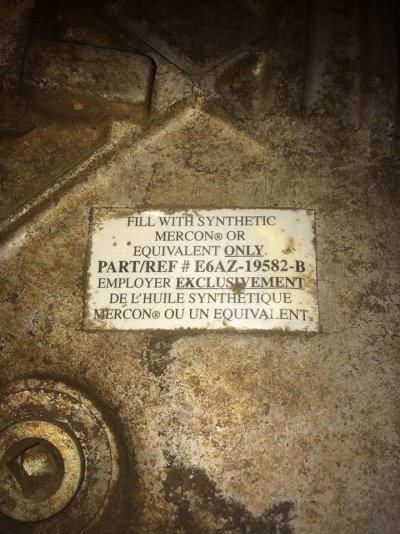

From the ZF5-47 Manual
NOTE: For vehicles equipped with the 7.3L diesel engine, this transmission requires use of synthetic Motorcraft MERCON® ATF XT-2-QDX or MERCON® equivalent.

I used to advocate sticking with ATF in the ZF-5 since that’s what Ford recommends, until I found out that ZF-5 transmissions are actually used in many other vehicles all over the world. They’re in medium duty trucks in Europe, and even in Chevy pickups down in south america! For non-Ford applications, ZF makes them with removable bellhousings to fit many other engines. In every application except our trucks, ZF recommends their own fluid called “ZF Ecofluid M” which is a 75w-80 fluid for auto or manual transmissions. I now use Redline MTL, which is a compatible replacement for the ZF fluid. Ford chose a different spec for our trucks in the USA, I guess they had their own reasons. I think you’d be fine with a quality ATF or something that’s a match for the ZF Ecofluid M.

Interesting... I wonder how synchromesh mtf would do in them then....
This was my thought as well. Using it in a g56 currently from the specd atf. Zero issues shifting cold, and quieter and smoother shifting when warm.
I knew of a zf truck that the guy switched the trans to synthetic gear oil early on. Truck had high ish 300k miles on it when I worked on it, and still shifted fine and was quiet.
