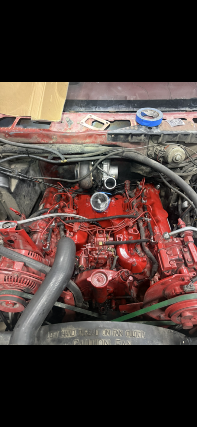

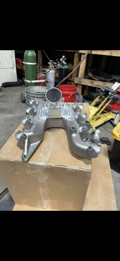

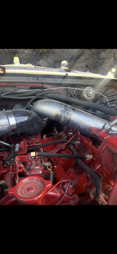

There’s some room for a good air filter spot. Justin finished the intake today and my last boot shipped aswell today

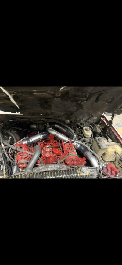

Ready to fire when I get my body put back together, just need to put my down pipe back and make the pipes, really excited hope this wicked wheel does better than the stock one and can keep my egts manageable
Very impressed with the aluminum return caps so far let’s hope I didn’t ruin an oil ring and they leak but the fitment is insanely great
Happy to rid with the rear cross over the the 6.9 injection pump hard return line

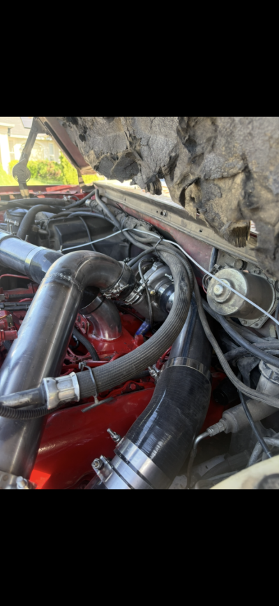

Very happy with this here’s the final look need to finish the intake just mocked up and a few odds and ends but very very pleased
Austin86250
Oct 5, 2021
1,014
682
idaho
I’m going to call this project an extreme success, more power much smoother too, quieter in the cab, no more white smoke, wayyyy better egts.
There is this 7% grade before I had to take it at 50 and still be at 1200 degrees but I just took it at 63 mph at 800!

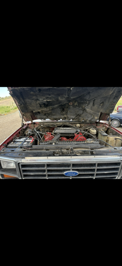

Ran it up and down the mountains yesterday for a couple hours still checks out I’m giving it a clean bill of health
