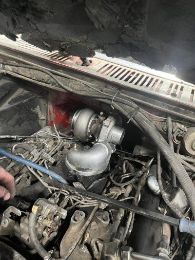

The results are impressive. I wonder if the same thing would work for a 088? I have a future project in mind.
If starting with no turbo, I would use something other than an 088 kit. They are the slowest spooling out of all kits I have had, and the integral exhaust housing/down pipe makes it impossible to change exhaust housing for better spool.
Intercooling does add performance, and an egt reduction, but you wont see a several hundred degree reduction with an 088, that unless you have really big fuel, will barely see 12psi.

I have it so I figure why not use it? I'm not looking for big numbers anyway. Just more than N/A.

088 is the same turbo as the 085 just different exhaust housings. Which I did so if he does the same as me it’s the same results
Yes, but the 088 uses an integral exhaust housing, would need to fab up basically everything on the exhaust side, including a way to support the exhaust side of the turbo. Not saying it cant be done, but is much easier to do what you did, with an 085 kit, or a first gen banks or hypermax.

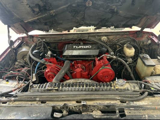

Finally all buttoned up on this! For now
Finished my intake and crank case vent
Justin at r and d days VC sucks for a crank case vent as oil vapor hangs out there and to try to make an oil fill, timing cover vent. But I have a seemingly a million other projects going on so that’s down the road
Justin is working on making the banks oil fill/ timing cover inspection cover breather. He has a 3d printed Prototype made he has no eta but cool to here!

Boost leaks found and fixed no complaints
Here’s a little video for fun id call this project complete

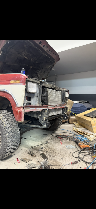

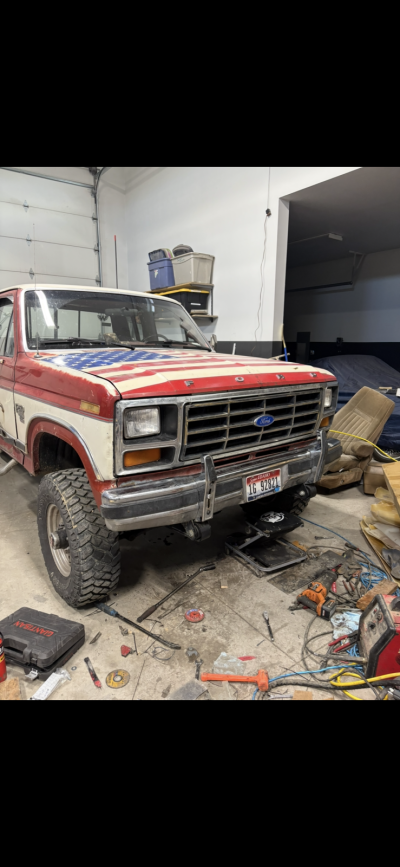

This condensor fits 300x better than the stock one, and steel so you can weld brackets to it a lot easier highly recommend this if you are intercooling a bullnose
Stock one is a disaster for this, the side lines are unprotected, they are aluminum, and the lines are bent in a way that makes them wider than the cooling area thickness
All three of Those issues lead to a hole being rubbed into my stock one
Was expecting that to happen though, and I was more than happy with this like it was made for me
Side question radiator is the original and the top tank is starting to leak just enough to leave corrosion what are we doing for radiators these days? Something quality and as good or better than stock, idealy something that isn’t going to break the bank but I understand when you need to buy once cry once
