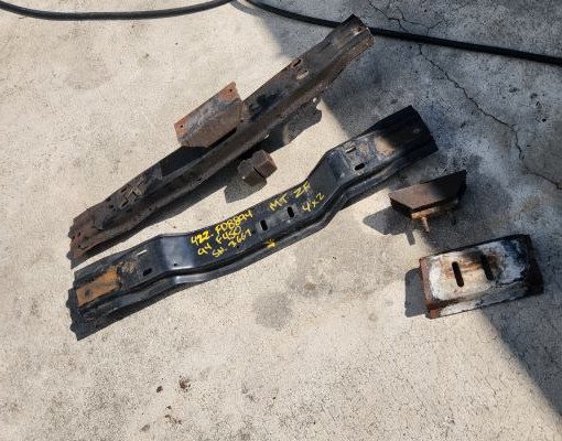

a 2wd ZF5 crossmember doesn't fit a 1995 F50?

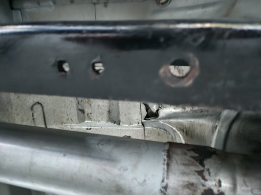

Does Ford not pre-drill mounting holes on frame for all trannys, regardless of what's going in? Lining up a crossmember for the stock zf5 and my frame lacks the single hole for ZF in bottom of frame. Or am I WAY off in where the tranny meets the crossmember?
In this pic what exactly is that weight in the IDI ZF5 tranny mount? okay to run without it attached?
Without a functioning crossmember for the ZF, i purchased one off EBAY for a 95/96 powerstroke... are the crossmembers different even though trannys from different years work?
Any help or input is GREATLY appreciated...

I can say that the only times I remember seeing one of those weights is with a C6. I call them head bangers because they hang so low and it's easy to hit one with your head while using a creeper under the truck.

Surprised the f450 ZF5 2wd didn't look anything like the older IDI I have. Waiting on the 95/96 powerstroke crossmember and will attach pic of it vs the other two.

here are the crossmembers.
Top Automatic e340
Second is the f450
two lower ones are the zf5 from 1990 and 1995 (lighter brown one)
don't know why but the bottom one with that funky weight had the center tranny mount holes a tad off.

Miked... its true. The e340 crossmember is very close to the one I used. Your angle info and work required can be done... with effort.
Now for those frame holes.
The auto frame hole is bigger. I thought originally the zf5 wouldn't work with the original bolts. But it all fit. And the auto truck had the holes for zf5 drilled correctly.
