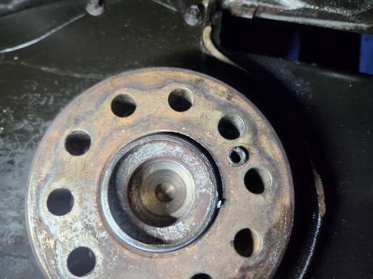

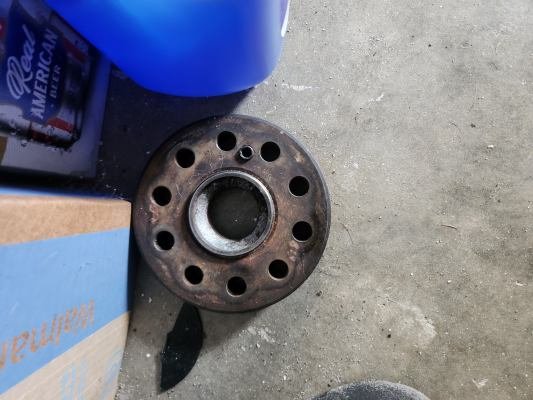

that darn spacer. Didn't realize it comes Completely Off! Wrestling with flywheel for a while and gave up. A few pitcher later, Eureka moment. Pulled it and Flywheel goes on. Here are my pics of it

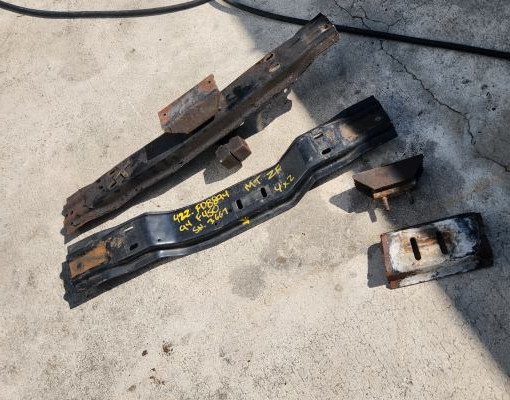

Thought the crossmember from a 1994 f450 would work. It doesn't. I have one from a 91 IDI and it is different.
Anyone know if the 1995 powerstroke crossmember is specific to year(s)?
Also, the IDI has a counterweight near the tranny mount?
