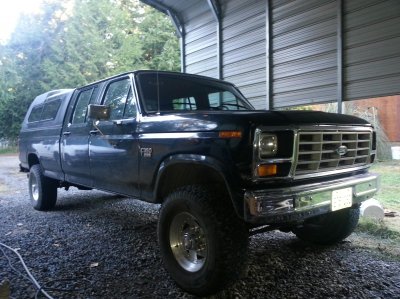

Thanks for that. My goal is to build up the 6.9 but I dont want to use the original parts if they are inferior to what else is available or what was improved for the 7.3. Most builds I read are posted pipe dreams so im gathering info and parts overtime until my build is realistic. My current setup is an 86' CC 72k original miles from the original owner. I've since put a turbo, exhaust and intercooler on, and if I go any further it will be on the spare 6.9 sitting in my shop. That way I can go nuts over time and make the swap when I'm ready;Sweet

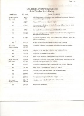

The later 6.9 and the 7.3 had bolt in piston cooling nozzles. The early 6.9 had press in nozzles and required a template to reinstall properly. I am not sure if they can even be reused. Check your block serial# on the top drivers side behind the IP gear cover. If any boring or honing is done the cooling nozzles will need to be removed. Nice looking truck. Those CC slantnose are a pretty rare breed with 4X4 and SRW.
