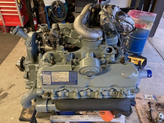

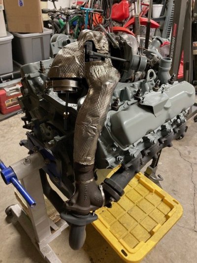

We're getting closer fellas! Rebuilt the turbo with fresh bushings and seals. Took me a hot minute to get the turbo in it's final resting home. Getting the passenger side exhaust manifold, turbo up pipe/slip joint, and turbo pedestal all lined up so they didn't bind was a chore but I eventually got it. Just had to loosen the bolts on the turbo and clock the hot side and cold side. Test fit the crossover pipe and all seems good to go. Wrapped up the turbo with all the factory heat shields.
Buttoned up the thermostat housing with a Motorcraft t-stat and gasket
installed lower radiator elbow with Motorcraft gasket.
Injectors are a mixture of new and old as well as the glow plugs being a mixture of part numbers. When I pull the 6.9 motor from my truck i'll transfer the brand new R&D IDI injectors and Motorcraft glowplugs onto the donor engine.
I noticed when I pulled the injectors on the 7.3 donor engine that it had some rancid fuel in two of the injector chambers. I'm thinking this would explain my rough choppy idle when I bench ran the engine before repairs. Compression numbers seemed great but all the supporting parts were just...junk really.

I absolutely see why people break the turbo pedestal on these factory turbos. They've got to be JUST right for them to all be happy together. Thank you for the kind words. Normally I rush everything and the end results isn't something i'm proud of. While it's not 100% new engine and parts i'm REALLY trying to put this used engine together with forethought.

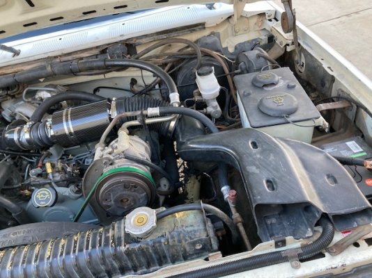

@IDIBRONCO It was definitely a gamble putting this used motor in from god knows were but it's turned out to be a runner. I was able to bust out this air intake today. It's a mixure of the factory ram air duct and a modded inline filter. The idea was to get the coolest air into the turbo vs sucking hot air from under the hood in the AZ desert. From the turbo is a silicone 2.75" 90 to 3" then to a 3" exhaust tube with barb for the CDR return, then to another 3" silicone coupler to 3" filter housing. The filter housing I modified to be 4" with an ABS coupler which then connects to the factory ducting. I'll probably change the CDR hose routing to make it cleaner with a barbed 90 instead of a straight barb fitting.
I'm curious of your guys feedback. Do you think this will be restrictive for a turbo'ed 7.3?

I don't know anything about inline air filters, never seen the inside of one, but I'm willing to bet it works fine until it packs with dust and tries to get sucked into the turbo. I had a cheap Spectra filter on my pickup for a while that caved in under vacuum, after IIRC a few months daily driving, and I'm in Western WA with relatively little dust. It sure LOOKS cool, but just thought I'd mention it. When you lose total boost or have to mash the pedal harder definitely replace/clean that baby.

@The_Josh_Bear It's definitely a smaller filter than i'd like so it'll absolutely need to be cleaned more often. When it's clean it has great power and is much quieter than the cone filter sitting on top of the engine like before. You could definitely hear the turbo whistle with the old setup but not so much now. I was looking into UMP filters but they're very big and expensive. I'd love to just get a factory turbo airbox with maybe a K&N panel filter but it seems like Ebay prices are just ridiculous now so rather than be a cry baby I made my own.

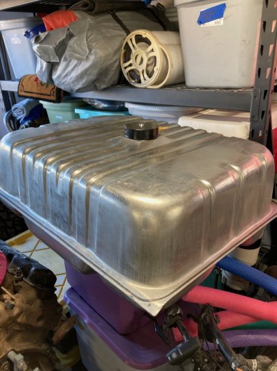

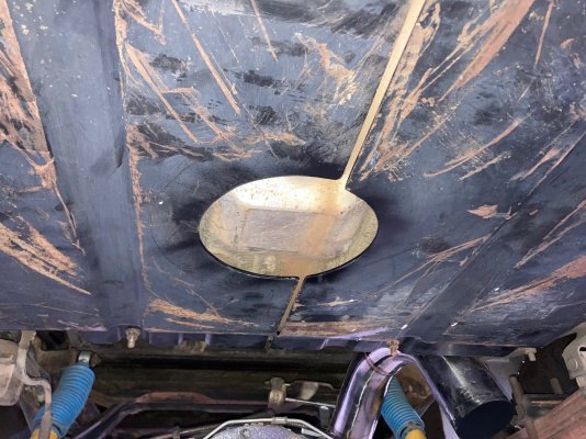

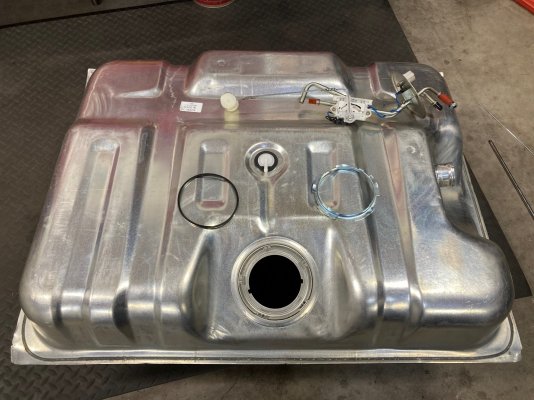

Pulled the skid plates one at a time to cut the sump hole out so I didn't have to fully pull the fuel tank until I was ready. Had to weld up the rear most cross member since the yay hoos before cut the rivets. The receiver was booger welded with only half the bolts holding it so I cut/hammered the welds off (110 fluxcore boogers) I have it ready to install now with all the bolt holes (6 total)
