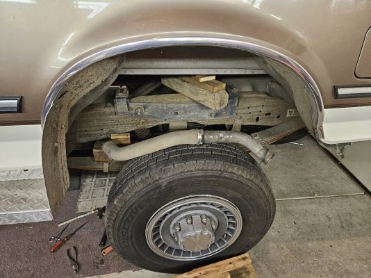

Thanks @Selahdoor for bringing up these notes from Garbage Mechanic. My rear brakes were never making sense and I just ended up leaving them a little loose, but not loose enough that they fall apart. I could get them where they work good and where fine running short distances, but after a bit more than a half hour run on the highway they would start chattering. If I keep going like that, they would start locking up.

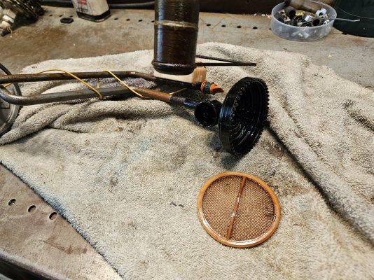

Now I need to pull my new rears and check the o-really's I just put in...
Good thing the truck is in the shop getting some luv.
