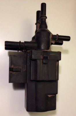

Yours should look like this:
All of the replacements I've seen look like this:
It's true that the replacement has one ring, but it's just a hose barb. The rings on the original valves (and the ones that the quick-connects work with) are further back on the stem.
Also, notice the direction of the outlets. The replacement has four up and two down. I don't know about yours, but mine had two up, two down, and two that went straight out from the pump. There's no way my lines would reach, even if the unit had the correct quick-connect barbs on it. My upper and lower hoses have right-angle boots, and the lines coming straight in had straight boots. Which presents another problem---if I were to cut off the quick-connects off the nylon lines and splice in rubber line to fit the hose barbs, the hoses would've have to make such a sharp right angle that they'd kink. Anyway, just double check before you buy....
