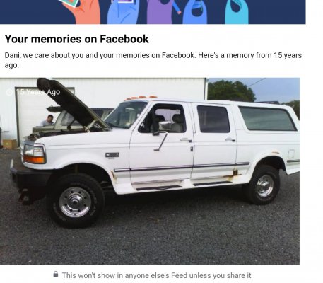

So this is embarrassing... This showed up on my feed while my kids were practically perched on my shoulders (my 12 year old is 5ft 2 so this was painful haha). They didn't recognize it because in their living memory it's been in pieces in my shop
The 12 year old was 12 weeks old when I discovered all the rust
Haha I have a '93 Bronco that has been in pieces in my garage since the year before my 12 year old was born. So I know exactly where you are at. Once kids came, time and money became even more scarce. No money to pay someone to do it and no time to do it yourself. We will get to them someday!!
