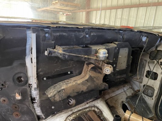

I know it's usually simple, but when I'm involved.....it gets kinda FREAKY! I'm just going to bypass it for now. All my money is going to get the tow truck drivable, and then I'm going to address my dually in a BIG FREAKING way. It's drinking too much oil outta the crankcase, she's tired and I think"the Piper's" bill is coming.
Well being in Florida you won’t freak out, as you probably only use the heater for a couple months a year anyhow. I believe I have read it is not good to cap the return hoses. Creates some freaky problems like maybe air pockets or a water circulation issue. So you might just want to run one hose in between the inlet and outlet hose connectors on the engine. I don’t recall but I believe they are both the same diameter. Other members can confirm or deny the myth.

Yeah, you gotta loop it, don't cap it.

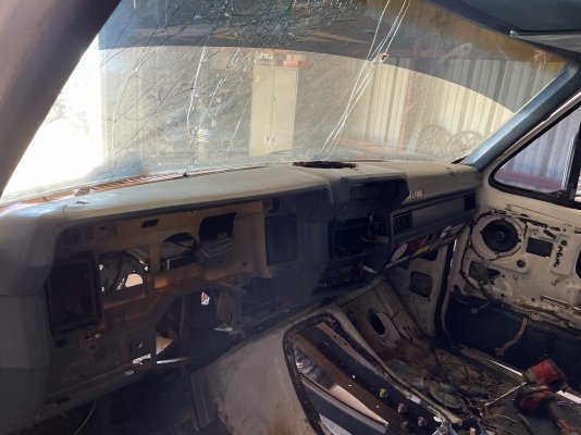

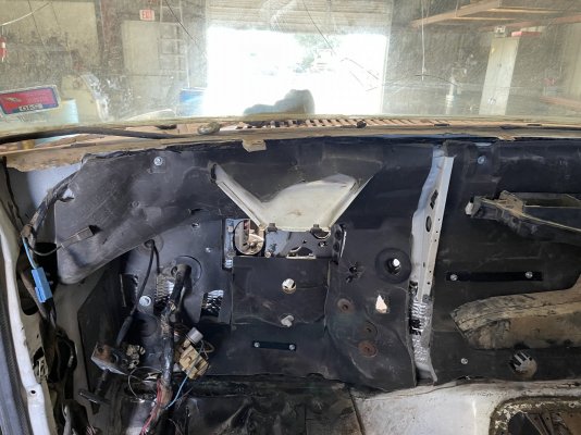

Oh I forgot to mention, my ignition linkage fully failed on my way home trip, can't shut off truck. Can do key on, but have to start with solenoid. Have to drop the fuse cover and reach around the column and push the rod to the "off position"
Oh the joys of having a tilt column. Going to tear into it tomorrow.
