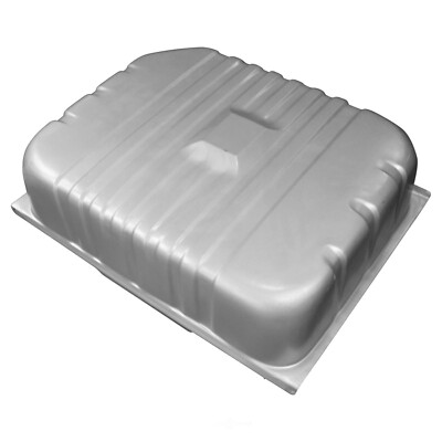

I got a killer deal on this new 38 gallon bronco tank thanks to @IDIoit. He mentioned where he found the best price and I got one that day. So I finally installed it, as my old 38 gal tank was leaking badly due to operator error. I dropped it last year but forgot to loosen the only critical hose clamp to the filler tube and cracked the neck seam by pulling it "just a little more". So it's been leaking ever since and so I can only fill it halfway or less. Which also means I can't do MPG calculations! Gah! But no more!

It's an Ebay special by TRQ. Was $147 shipped back in November.

BTW this TRQ version actually has a good install kit for once. I got a Spectra brand tank some years ago and it didn't come with half the stuff you need. The only thing this was missing is a longer piece of wire for the fuel float. But the bolts and stand offs are great, comes with some copper tube to extend the pickup. I just used submersion-rated fuel hose with no shower head.

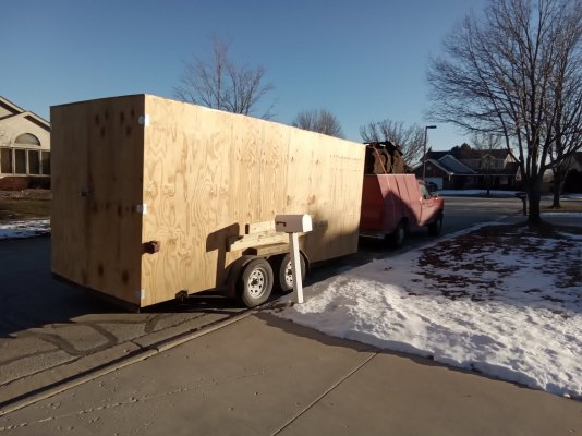

I wish I could do some of that right now. Since the lows are going to be close to zero for the next couple of nights, I think I'll probably wait for a while.-Lame

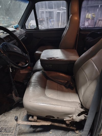

Getting close to comfy seats
Looks great!
I was wanting to put super duty seats like that in my CC, but everyone around here wants 1k for a ripped up set of 20 year old seats.
I ended buying centurion seats, but I only wish they were vinyl or leather so they would clean up easy.

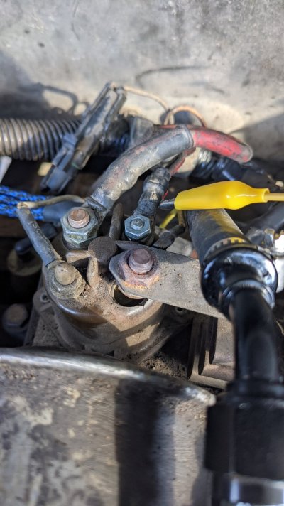

Got my controller deleted for the glow plugs. Just need a 150 amp to go on the power cable. Came out pretty clean, original solenoid knocked the terminal out surprisingly.
Truck has still been hard starting despite new GP system, and electric fuel system. It's about 30° F. I think though, when starting in cold weather you hold the gas pedal down right? Haven't tried it yet.
