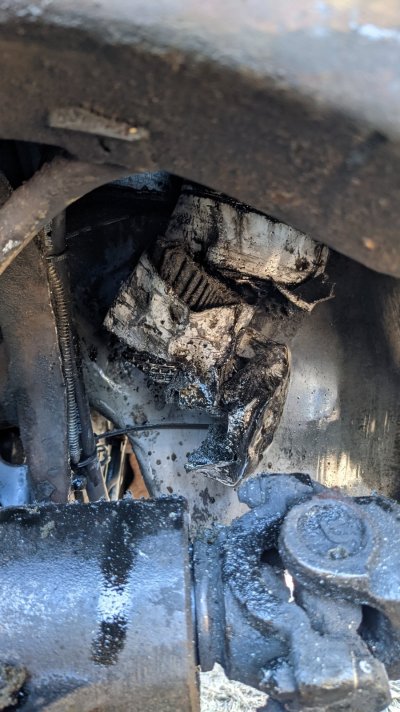

I've had a hell of a time today with a durn oil change

Last time I changed oil in the black truck had a similar stubborn filter. Broke two filter wrenches, finally ended up using a large 4" or 5" diameter exhaust clamp around the filter housing then used a long chisel and BFH to tap tap tap until it broke free. Half hour oil change ended up taking several hours. The filter was a motorcraft 1995 (typically used on powerstroke) and I've used them for years with no problems, this one for some reason stuck like **** to a wool blanket.

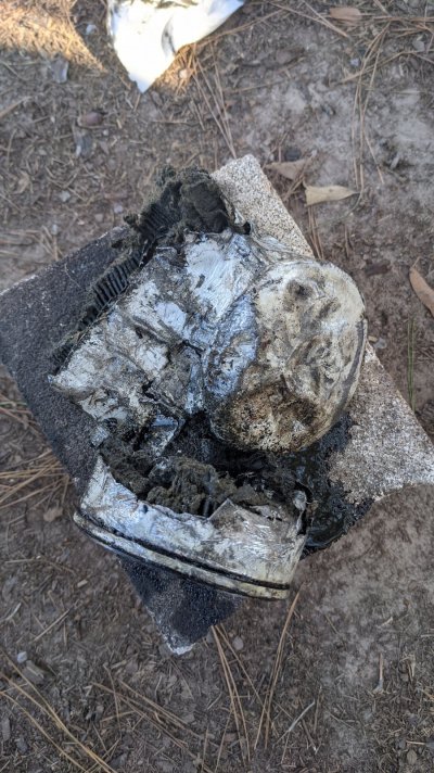

NeverHave-I-Ether

Yuh I won. Took 3 days to do the oil change. For when I had time and tool runs. Snapped an oil wrench which I returned and bought a pair of channel locks. Ended up using a saw zaw, heat gun, hammer,and channel locks to get it off. Probably spent a total of 8 hrs trying to get it off.
Guessing you did all the below and it was heat or chemicals that were the culprit of the seal not releasing. But for newer members who have not done many oil changes.
1) Clean the seal surface with a clean rag.
2) Put oil on the filter seal before screwing it on. (Or you may be in for a fight.)
3) Tighten the new filter as much as you can with one hand.(If your like the Hulk or Popeye stop when very tight.) Do not over tighten like its a big nut. You do not want to stretch, squeeze out, or damage the seal.
4) When possible use a quality filter wrenched for that diameter filter. Once you crush the filter in, it looses all its integrity. Personally I use the below pliers (I do not go past hand tight and change oil every 3k miles.). If the pliers did not work, or started to really crush the filter. I would grab higher up with a filter wrench.
Glad you got it off! Keep an eye out for oil cooler leaks, all that jarring could send some marginal o-rings and seals on the oil cooler system to the breaking point.

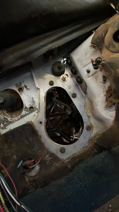

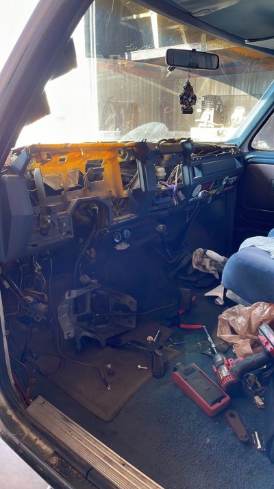

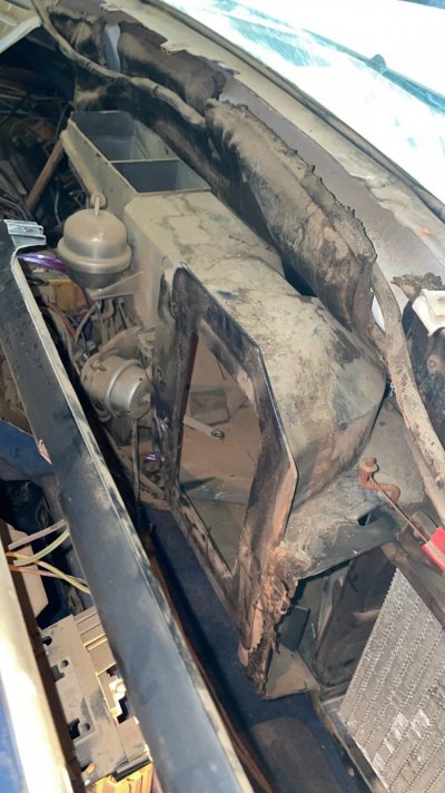

I’ve done a few things in the last couple weeks. Not done yet. I’m very thankful that I picked up my little Volkswagen because it’s given me so much time to do things I’ve always wanted to do to this truck. Fixed the firewall, went through all the janky cab wiring and weeded out a bunch of stuff that wasn’t even hooked up. About ready to install my traction bars. I also fixed the little blend door thingy that was preventing me from seeing when it was cold out.
