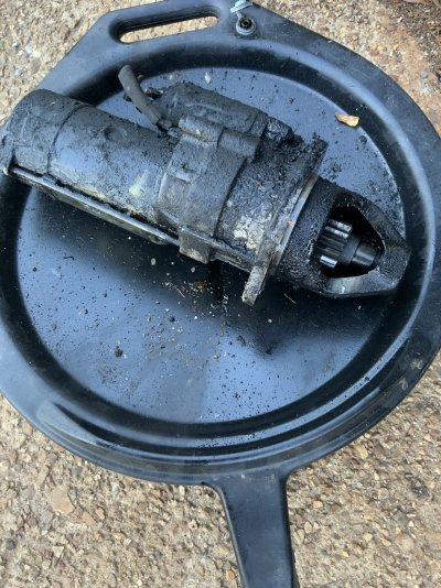

truck Quit starting on me, I turned the key and you hear 1 click from the passenger side. Went and tapped on the started would turn over very slow. Turn the key off then try it again it was still slow but it was a little bit faster. Tried it again. Same.
So I pulled my starter just to find a bad oil leak that leaked mostly on the side of the passenger side back of the engine, starter, solenoid, and exhaust manifold. I never seen a starter this bad. Yet I’m still kinda new at this. So I’m guess this is my issue, with funds being tight looking for a used starter, I’m also going to replace the solenoid on the passenger side fender. And replace the battery cables because they’re all corroded inside the plastic coverings. If I’m missing something, please I’m all ears. I just want to get back in her and drive.

Low voltage/current to the starter which is very most likely due to your bad cables.
#1. NEW BATTERY CABLES Must have good cables to get enough current to the starter.
#2. Clean the starter then take it to a parts store chain and have it tested before you buy a new one! .
#3. Oil leak. Commonly it could be valve cover gaskets, the valve cover bolts ternd to get loose (or the gasket shrinks a little bit. Check if loose and snug them up. Sometimes the oil dipstick tube where it enters the crank case can leak and blow oil back onto the starter. Depending upon year and model it is either sealed with black permatex or an o-ring.
Note: Create a signature with the specs of your truck, which will appear in all of your posts and readers will know what truck you have because fixes often vary with year and model.
