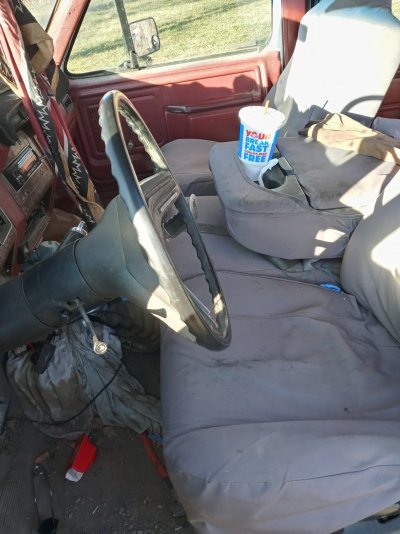

I'm not done yet I'll have pics on my build page when I do. Had to cut the motorized stuff off the bottom of drivers then I bolted the bench seat runners on to the actual seat. Some washer for spacers and drill some holes. Using really big washers on bottom side to spread the stress out. May weld something on haven't decided. These are super duty seats that the guy I bought it from didn't know what they were. Seems to be newish king ranch seats I think. Middle console is out of a dodge 3rd gen. All leather. Using original seat belts. I've a full super duty seat swap before. It was all mechanical so I just used lots of spacers and slapped em in. Trying to do a nicer job this time. Pics are of my other truck

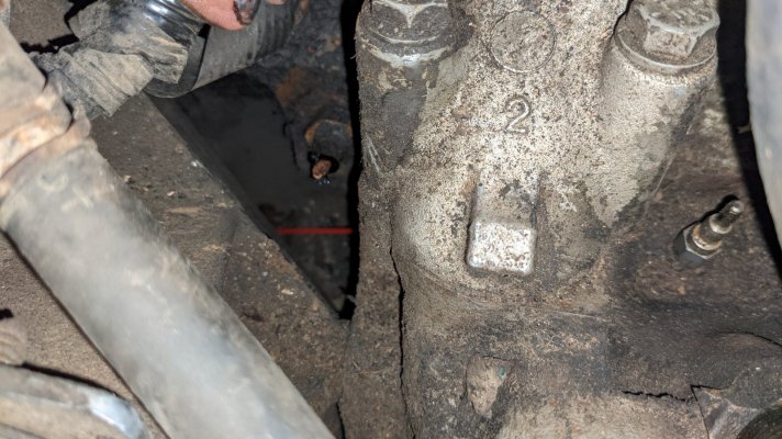

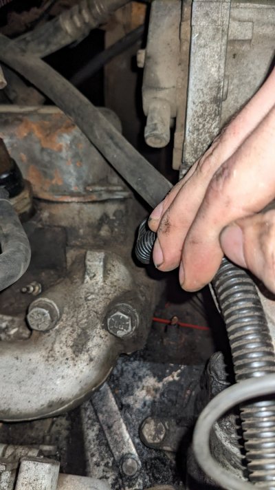

Usually starts after 20min of cranking with a gas rag. I know that's a bad sign of compression, on the flip side though I get 17mpg with 4.10s on 33s, and blow by is minimal. It always starts though and then runs fine. To be fair, I never did let the throttle down while starting so need to try it. New fuel system from tank to IP. It all checks out as good. I just turned the key. Seems to crank fast, maybe not fast enough...
I do have this loose wire and sensor though on the driver side:

Its a little hard to tell from the pic but yes that looks like it, but it has two prongs not one so that might be broken or the wrong sensor. But it is located on the front of the engine. The concept is power when the key is on goes to one terminal on the sensor. When the sensor is less than about 115* it conducts power between the two terminals. Sending power to the IP soleniod to help cold starting and to the throttle solenoid to hold your idle up 50-100 rpm when cold.(Idles smoother and higher, helping warm up the engine faster.) Follow the wiring back from the IP solenoid and the idle solenoid and see if it ends there or if it hooks up to another sensor near that one.
Also do you have a block heater? If so use that, it will help out a lot. But it should not take 20min to start your engine. You may have multiple issues. No timing advance (Above), timing is off, and air intrusion. Unless your compression is very low (Sub 300psi on most cylinders.) I do not think that would make it a 20 minute job.

Based off another image I found it's the temperature gauge sending unit. Know what that is now.
I think that may actually be the temperature warning light switch. It’s threaded into the block just in front of the driver’s side head.
The temperature sender for the gauge is in the driver’s side head, right above the exhaust manifold.
