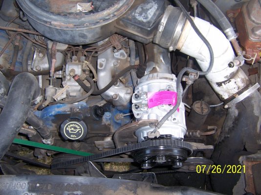

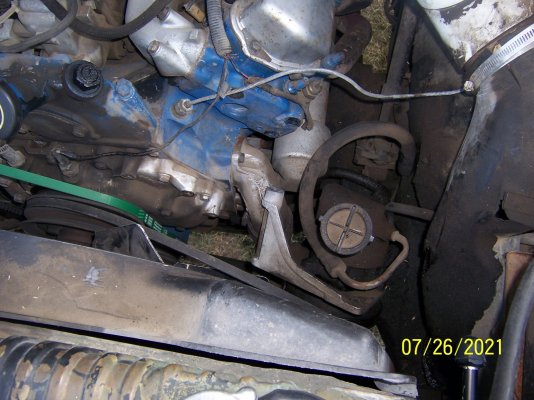

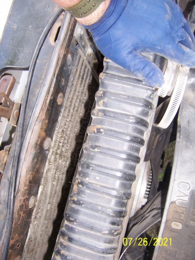

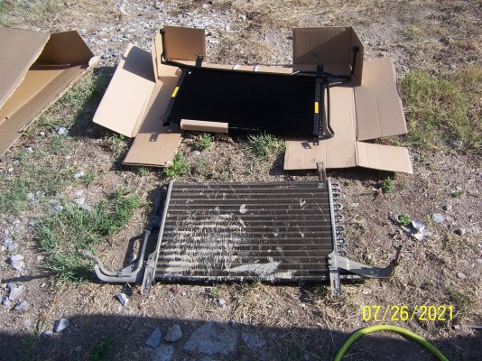

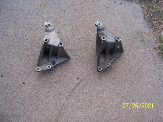

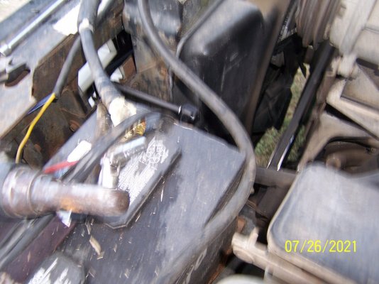

I've been "fixing" the A/C in the Blue Truck for a couple of years now, but today, I FINALLY got started. I was going to over the weekend but things got in the way. My first step was to replace the condensor. I didn't want to try to remove the grille because things behind it need to be straightened from deer damage and I was not in the mood for that. I thought that it could come out with the radiator still in the truck and I was right. I took out all of the bolts for the fan shroud and the radiator and I could push it far enough back to pull it out. That wasn't without it's issues though, the lower mounting brackets kept hanging up on the studs that hold it in place so I took those off (actually I removed one and just bent the other one out of the way since I wasn't reusing the condensor). I got the new one slid in and bolted the radiator and fan shroud back up. Then I wasn't ready to stop so I decided to replace the compressor. That wasn't a straight forward job because someone had gotten a little bit ham ****** and stripped out the threads in the p/s pump pivot bolt so that was the time to replace that bracket (good thing I have one or two laying around). I got it replaced and put everything back. I was going to throw that aluminum bracket in the scrap pile, but then I thought different. These haven't been made for 30 tears or so and aren't getting any easier to find. If I wanted to, I could Heli Coil that hole and still use the bracket so it's going to stay around.

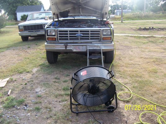

It was hot, pretty humid, with little wind so I decide to keep myself cooler by making my own breeze. It also helped the radiator cool down faster too. I've had this truck since January of 2013 and it's never had all four belts on it. I have to say that it looks MUCH better. I'll worry about hooking up the hoses tomorrow. Everything is still sealed up with the plugs so I won't have any dirt get in anything.
