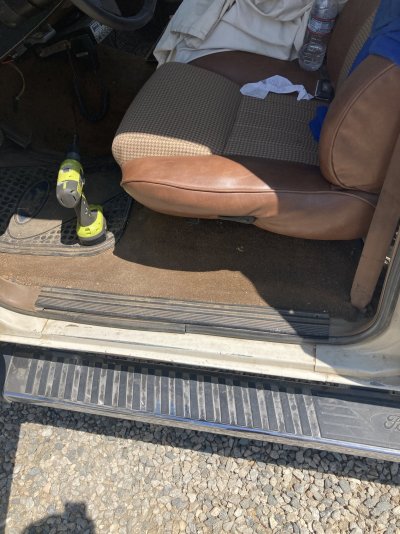

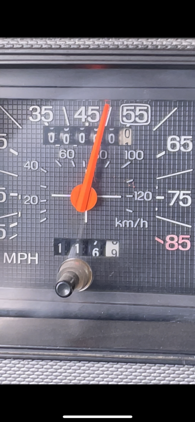

this happened today. I wish I could find out if I just crested 200k or 300k. The previous owners (with all due respect) are interesting people, take that as you want to. They insist that it had 85k on it when I bought it but I know that to be not true at all. Still wish I could figure out an estimate on what it really has on it. I’m assuming 300k

Often the front drivers seat and door will tell you a lot about it’s millage. If the seat is not torn on the corner and not a re-upholstery job, it had 85 k. If it was torn and missing foam it was likely 185k. If it was trashed or re-upholstered then more like 285k. If the door shuts nice figure 85k. A little loose and have to pull hard to make it shut, figure 185k. If loose on the hinges, missing part of the seal, door shakes on dirt roads, door rest/handle broken or missing figure 285k. It’s not scientific but it’s often pretty accurate.

Yeah its got all of those. That’s how I knew they were wrong on mileage. The door was very loose and there’s a nice rip in the seat. One thing I also looked at were all the body mount bushings. None the less it’s been a good truck

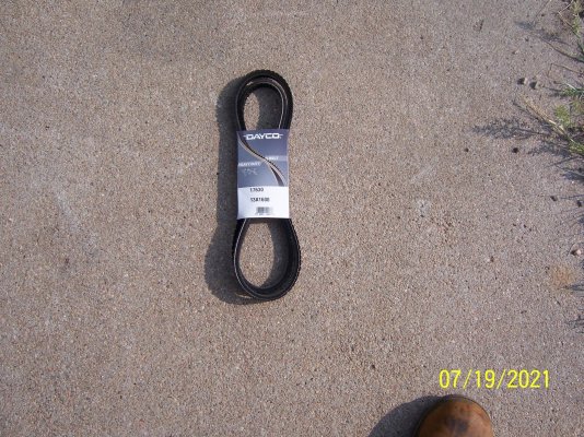

First off, due to standing on principles, I'm a flip phone hold out. I use a flip phone, a Kodak, and a PC. Since I left my camera in my garage yesterday, this is a two parter.

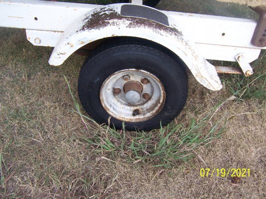

Yesterday I picked up the final missing part to (hopefully) put A/C in the Blue Truck this weekend. Without the belt, I would never have any cool air inside the cab during the summer. After buying that, I went back to my garage to put new tires on my miracle friend's boat trailer so he could take it home and sell the boat and trailer. First off, 4.80-8 tires aren't really much fun to work with. Then, as I was removing the second old tire, with a generous helping of swear words thrown in, I noticed the the tire said "Montgomery Ward" on it. From what I remember, they closed down in the early 90's. so that means those tires are probably 30 years old or older. That explained why they didn't want to come off very easily. He's still trying to be a penny pincher so he doesn't want to sell the boat with new tires on the trailer. He's got a surprise coming. I told him that the one tire that I looked at wasn't any good. Both of them had rubber coming off of the sides by the time I got the trailer pulled the whole block and a half (in 4 LO, 2nd gear non the less) to my garage. He told me that everyone wanted $11 to change out one of those tires where he lives so he thought that he'd bring them back to me. I'm going to tell him to bring them as many times as he wants to. I'm NOT going to be putting those junk tires back on anything.

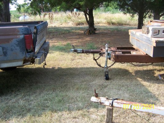

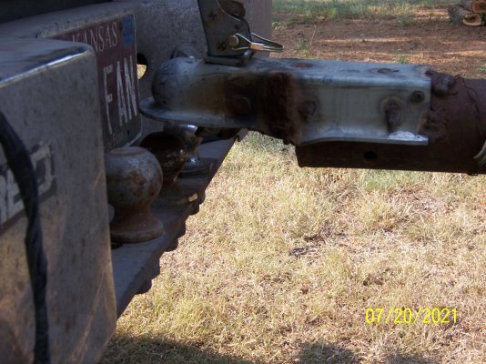

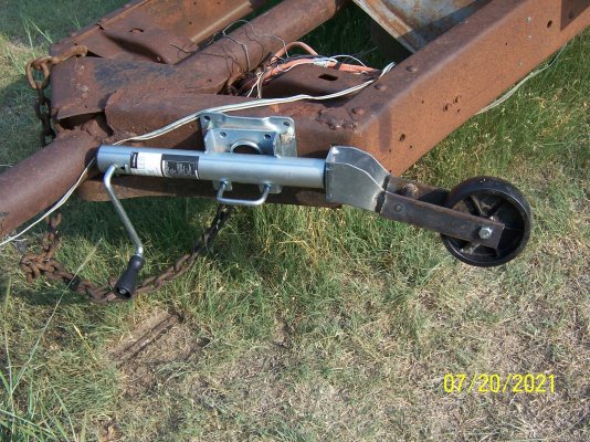

Today, I decided to finally mount my Harbor Freight jack onto the front of my pickup box trailer. It wouldn't lift high enough to get the trailer off the ball on my bumper (it wouldn't even reach the ground) so I had to modify it a little bit. I had everything all measured out and then decided that if I should extend it 2 more inches just to be sure. It sounded like a good idea until I tried to get the trailer unhooked from the truck. It wouldn't raise the wheel at the bottom high enough to even get the jack vertical. So I had to cut 2 1/2" off of my extensions and redrill the mounting hole for the wheel. The I had to cut off the extension pieces so that they wouldn't drag on the ground (good thing that I have a grinder and some cut off wheels). After that, everything works as it should now. Of course now I'm thinking "why didn't I do this YEARS ago?" I knew that I had to drill mounting holes in the trailer frame, but I wasn't planning on modifying the trailer jack extensions so I only managed to get half of the yard there mowed. At least I know that the grass will still be there tomorrow.
