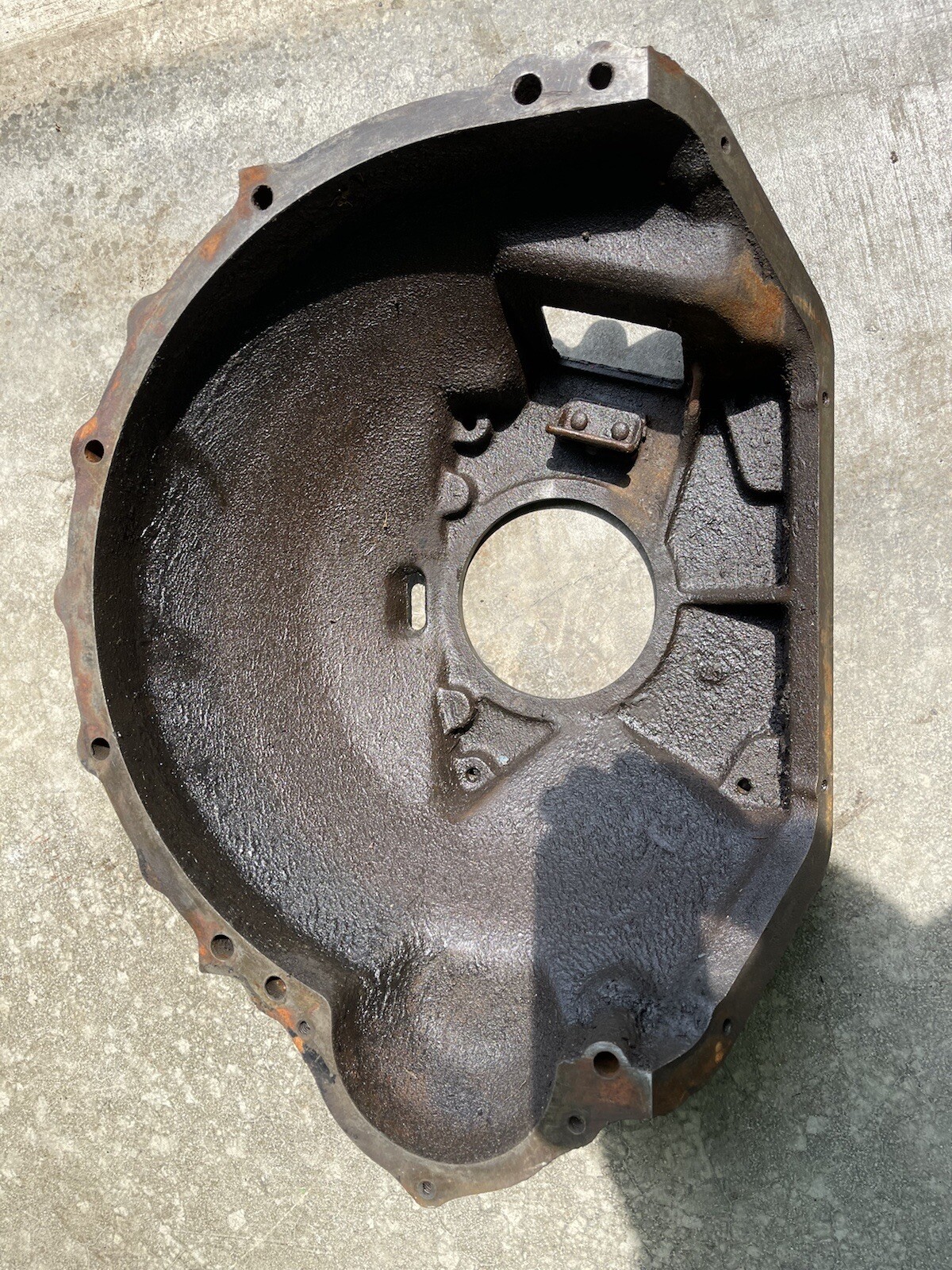

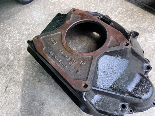

I don't know the part #, but the key to these bell housings is that there's no holes for a starter to bolt to. The big block (460, 429,etc) bell housings are all most the exact same, the top 2 bolts are correct but the middle 2 bolts are about 1/4in off. ...
Not sure if I got it right about holes. On eBay
there are a couple bell housings with part number CTA-7505-B,
one seller replied that it is for gas engines only. So it has to be different part number then.

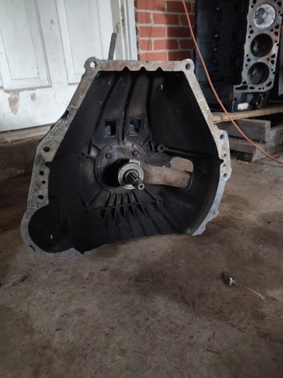

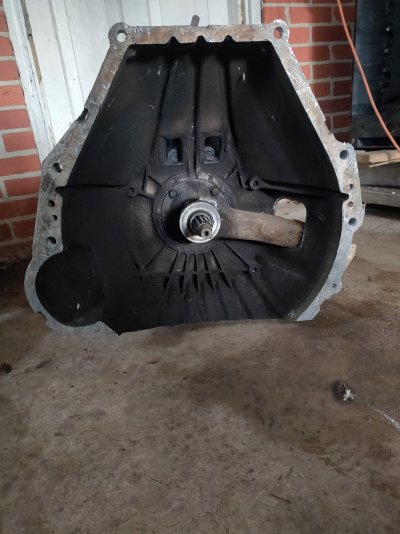

That's what you're looking for.

Sadly I am all the way across the country from sunny Florida. Shipping such bell housing that far will likely be cost prohibitive for me. Appreciate your offer though
Ha, it's raining here and humid and uncomfortable! I just looked up bell housings on ebay. There's no diesel bells, and the 460 bells I saw were crazily priced. Certainly nothing I would buy and start drilling on.
It has been quite awhile since I checked, I compared a 460 bell against the 6.9 bell, both hydraulic same year trucks, and modding the 460 bell wouldnt work. cant remember if it was because of room for the clutch/flywheel or if it was because of not enough room to drill the holes.....
3,291
3,743
Yeah, I saw a few threads about it. I'm not a machinist, so I wouldn't gamble on it. And it seems like the consensus is that it won't go, and at $450- $550 plus shipping I'd definitely not even try.
