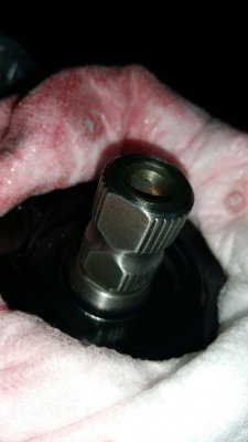

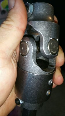

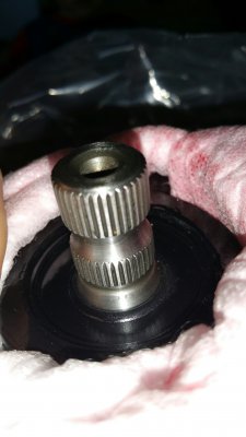

I got mine today, looks like the threads are sort of dicked up on the pitman arms side but i think it will be fine. The splines on the shaft side look much better than the reman i got from autozone. The borgeson shaft doesnt have a through bolt but a set screw, not sure how much i like that as if it loosened i could slide off.
Gotta remmeber they're 19+ years old shafts inside what is a reman steering box. I'm sure some they get back are too messed up, but some dings and pits are still useable. My threads have some pitting inside where the pitman are will be sitting. Where the nut will be they are in good shape.
I'm going to locktite all the Borgeson set screws. I agree with your concern on them backing out and not being a through bolt like the factory one.
We have a Flaming River shaft in one truck, and the set screws tend to do the same. You'd think they'd stay put with the locknut, but no. Absent-minded me, I keep forgetting to loctite 'em.
