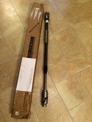

Sorry to bug you about it. Have you found a place to get it for the best price?
I have an answer now
Long story:
http://www.ebay.com/itm/291511389293?_trksid=p2060353.m1438.l2649&ssPageName=STRK:MEBIDX:IT
I emailed the seller of this eBay store on March 21 to see when they'd be selling them again for $223.20. After a few messages, I garnered that Borgeson was in the process of moving manufacturing from CT to SC, and they were understandably a bit behind on orders. They said they couldn't open the eBay listing/store, but if I called them to order a 000981 they could get me set up. So I called them and it turns out its a speed shop called Spohn Performance based out of PA, and their website doesn't even list the shafts, but they sure do sell them!
So I called and ordered it on March 22nd and got it today. They're a bit slow, but it sure seems like a mom n pop shop, and I didn't have the RedHead yet anyway so no big deal. I called a few times just to check on it and it finally shipped this past Monday. I assume this was likely more due to the Borgeson move than them as the storefront selling it.
So if you're not in a huge hurry, this seems like the cheapest option. By a long shot. There's a few other listings on eBay as well.
Amazon has them too for cheaper than Summit etc.:
http://www.amazon.com/Borgeson-0009...ue&ref_=ox_sc_act_title_1&smid=A2L77EE7U53NWQ
Amazon buying tip: When I'm shopping for auto parts on Amazon and I see that there are "used" parts available, (the "XX used from $***.XX" button) it is almost always parts that have been returned to Amazon and have slightly damaged boxes, so they're discounted by Amazon to get them gone, but they are by all means NEW. I've bought many parts for cheap by buying from "Amazon Warehouse Deals".
With that said, they've got one Borgeson 000981 shaft as of NOW for $244.08 plus whatever tax and shipping get it to you. That's the 2nd best current option, and arguably probably is a lot faster.
Other than that, regular amazon/eBay/summit etc/direct from borgeson is all about the same.
Good luck
