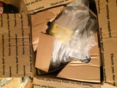

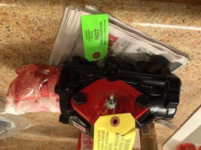

Look what the mailman brought today. FAST SHIPPING!
There's still time!! Looks like $30 off list at this point!
