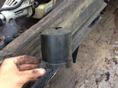

Waystro thats not the boot I Need Ineed the acordian one on the steering shaft close to the firewall. I have been busy and have not been on the computer much in the last week thats why I didnt get back to you sooner
Man I already sent it send me your PayPal and I'll send it back to you
My 86 does not have that boot up top if I remember correct.
