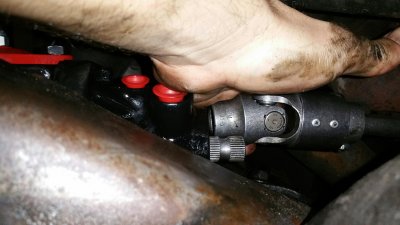

I gotta say I'm not too pleased with the Borgeson steering shaft. It's high quality, but i collapsed the shaft all the way, and this is how close it was to making to the steering box shaft. I had to actually completely unbolt the u joint inside of at the steering column, put it in a deep as it would go into the ujoint, then unbolt the steering box and slide it on. It fits, but this leaves the steering shaft as non collapsable, and i'm not sure how safe that is in an accident. It wont come loose or off but it is not easy to remove or safe. I used blue loctite on all set screws.
The steering box is excellent though, i cant believe how tight my steering is now, i did upper and lower ball joints, inner outter tie rods, power steering hoes, rotors, and bearings at the same time. I didnt find any failed or loose parts other than the steering box though so i think the only thing that tightened it up was the steering box. I moved the steering lock to lock atleast 100 times when it was up on the lift and couldnt get it to take fluid. I had to actually start it to get it pump fluid and work the air out. I had left it sit for 4 hours today before doing that and it still didnt drain from the reservoir.

I'm thinking there are two part numbers that fit and only one you have to cut, but this is only from listening to what others have done. And I'm not sure which is which because I get them mixed up, but I think they are only one number apart.

Went back and found where some were talking about it in OBS chat on the ORG. From what I gathered, most cut 4.5" out of the 000981 and for some reason the 000982 works without have to cut; although, it is not specified for the 92-96 truck, but for 97-04.

That's weird. You'd think they'd sell the right unit cut as it should be. As precisely engineered as it is. What a pain, now I gotta pull my steering box and shaft again.

I cut 6" off mine. I just made it match the factory one in collapsed and extended length. 4.5" would've been enough.
I didn't google it before hand, I just did it. I don't imagine I'll have further issues. I just got it together Thursday, will give a fuller report soon

I read the instructions that came with it and it didnt mention cutting it. I figured when i paid almost $300 for a part, that would require no extra effort on their part to make the correct length, would come as it should be installed. Sure it's easy enough to cut but i assumed it was designed in that way specifically to prevent it from being able to come loose from the steering box since there isnt a through bolt coupler and just a set screw. I can't imagine there are trucks manufactured that vary 4-6 inches in shaft length.
