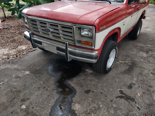

Can you believe this, of all the ungrateful mechanical children.......it got a new and upgraded timing chain, water pump, thermostat, and thermostat housing. On top of that 2 full days of labor which includes diagnostics. And NOW it wants a radiator too. What can I say..........cheeper than a car payment! And it looks cooler too.

Whew!, It's all new, radiator and hoses as well. Maybe it's happy. I got a 2 core radiator instead of the single that usually goes in there so that's beefed up with the timing chain. The new radiator didn't have the same mounting spots for the shroud, so it received the blessings of zip ties until I decide to do something different and I finally added a coolant overflow. The coolant overflow isn't factory, and it really blends in, but if you look closely you can see it. I was thinking that the shroud is unnecessary since it's just a driver, any thoughts?
If you do any city driving, I recommend that you keep the shroud
I would keep the shroud...that is my sincere, honest, I-would-not-try-to-steer-you-wrong-Buddy-you-might-thank-me-later opinion...
If you have to make brackets to get it all to fit...I think that it is going to be worth the effort in the long run...

That's kinda what I think. I want to get a nice shroud at my buddy's junkyard before I go to making brackets though.
