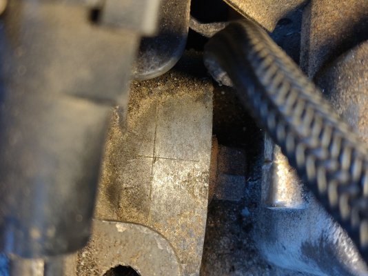

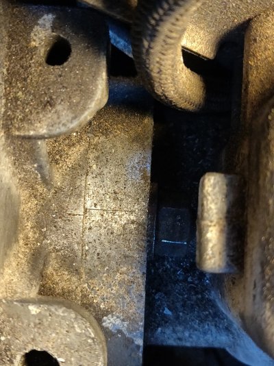

I attempted to time the tow truck. After I got it warmed up and ready to mess with I figured I'd make a note of where the marks were at the beginning. That was easy enough......they were lined up straight, that can't be right. I ended up moving it towards the passenger side a little more than the thickness of a quarter. My timing light only shows advance and the luminosity timing method is supposed to be set ATDC, so there was a deal of guess work but it "seems" better. I fooled with it for a couple hours and finally got tired of it. I'll be curious to see how it cold starts.

Never messed with the timing on a truck before. But have read advanced cause wmo burns slower. Gale banks has a series on killing a Duramax and he messes with the timing it is kinda fascinating. Can't remember which video it was, sorry
