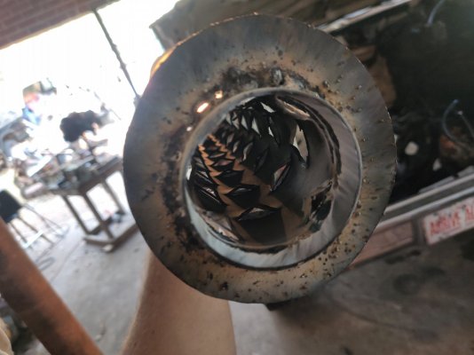

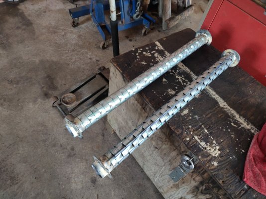

Check this out! I've been accosted by my super loud exhaust long enough, so I did what any reasonable red blooded American would do........I found a YouTube video. Anyways, I found one where a guy made his own glass pack for his bull dozer and he had back to back before and after of it working. Needless to say, it was simple and impressive. If you saw how I did my pipes, youll remember that there's no way I can fit anything under it so my idea has been to put a muffler IN the stacks. That's basically what I'm doing, but I'M making it. My ceramic packing material will be here later in the week so I don't have it done yet, but here's some pictures of my baffles. They are 36" long with @33" of baffle. The packing will wrap around the perforated area and I'll slide them in my stacks. This should really help. What do y'all think? Anyone else try anything like this before?

You gotta let us know how they sound... And are you taking commissions? Haha

I really wish I was more technilogicly savoy, so I could make a before and after video. But I'll try to discribe it the best I can. Right now it's unbearably loud with the window down. I'm really not into the "obnoxious jerk" scene and I feel bad sometimes because it is SOOO loud. Loud pipes save lives, but these are killers!

No I haven't tries this, but it will work. It will also be quieter. It's a part of routine maintenance to repack the muffler (sometimes called a silencer) on ATV's and dirt bikes. That's basically what you're doing, only you're building the internals first. How quiet will it be" that partly depends on how much packing you put into the stacks.

Sold a guy some auger flighting and an outer pipe the other day. He's going to build his own muffler for a Kenworth with it. Curious to hear how it sounds.
