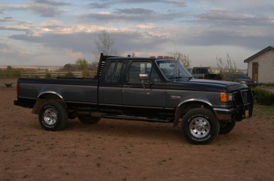

Welcome to the site. Nice looking truck. I have a '91 SC painted the same way.;Sweet
