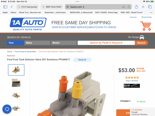

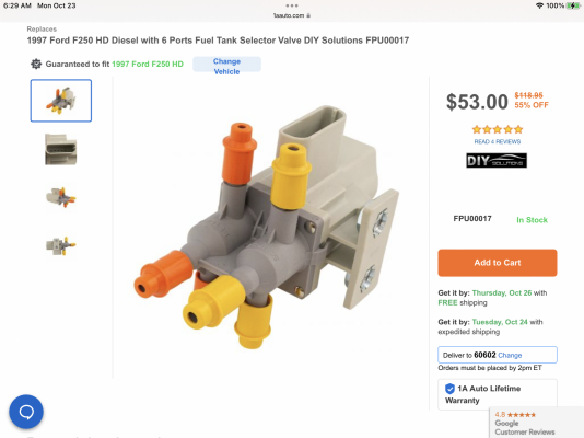

This is the fuel selector valve. They are the same on the IDI or 97 powerstroke. You can see the two different sized ports. The smaller is return, the larger is supply.
$53.00!??!?!!!!???!?!?
Where? WHERE? I bought 3 of them for almost $200 apiece! Then I decided to hell with them. But, that is a decent price…
Sorry to sidetrack but I couldn’t help but notice…
Another China knock-off. I haven't heard any bad things about them yet. The original Pollack valves to not have a very good track record, not sure about this one.
The one on my 83 came from OReilly several years ago, think I paid around $45 for it. This was pre covid though.

The market is flooded with the Chicom FSV`s in the $50 range. Look exactly like the OEM Ford Valve. It is plug and play. Electric connector plugs right in.
I bought one a few years back when I up graded to the 38 Gallon tank, and replace all senders etc... I ran off the rear tank mostly, and just kept the front tank for a back up. I switched the valve a few times and worked ok.
One day I clicked it back and forth to make sure it was working, and it got hung up and wouldn`t go either way.
Pumped fuel from the rear, and returned to the front tank, which eventually over flowed. -cuss
Removed it and gave it the deep 6.
This is why I decided to just bypass mine and not have to deal with that issue any more. It is really nice to be able to use it as designed and having to manually run the switch to transfer fuel between tanks, but after my experience with drawing from one tank and returning to the other, I was done with messing around with FSVs.
