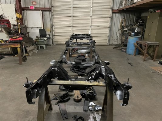

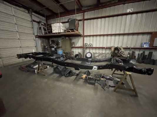

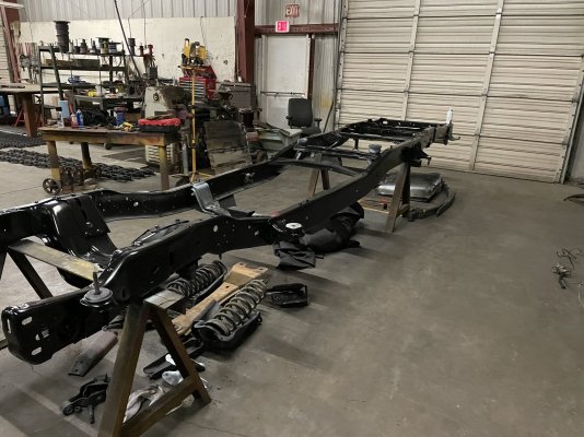

I seriously didn’t think that a roller brush would go on so flat. But it looks so much better than the spray I was using. I used a spray gun for the primer but I didn’t like how finicky it was plus I wasn’t entirely sure how to use it properly. This is also much thicker of coats and it doesn’t run so that’s super cool. Anyways. Frame is almost done being painted. I had to drill out the spring hangers as well and I have no desire to ever do that again

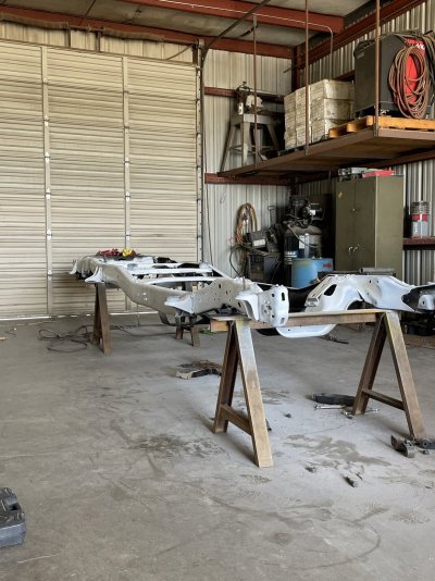

Did you sand blast the frame before painting it?
What type of paint did you use?
Laine D
Jan 23, 2019
1,362
1,945
Northern California
I wire wheeled it and used a cool little corrosion remover disc that cut through the surface rust real well. I used rustoleum clean metal/light rust primer and then just rustoleum gloss black metal paint. Painted the primer with an air gun and then I rolled the black on. A lot of hot rod guys used this stuff and it seems like it holds up really well as long as you don’t use aerosol. I figure for a California truck it will be good for a long time.

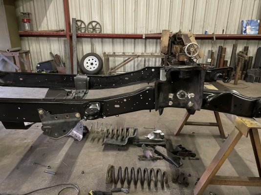

I’m bad at getting photos when I’m in work mode. Today I got all the brackets mocked up and drilled all the holes. Bought all the bolts I needed (didn’t wanna use up all my grandads). I’m wondering if I should weld a couple beads on all the brackets for that extra assurance, even though I highly doubt I’ll have any issues. Just figured while I’m here might as well.
Now I need some cheap wheels so I can I bolt up the axles
