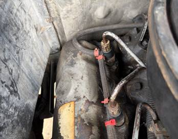

Any idea on how this return line kit runs? I think the guy before me may have done it wrong but also it seems like I have one 90 degree (bottom left) and it should just be a single? Unless I am missing something.
forget the specifics but it’s year-dependent and this is the “older style?”. If I understand your issue correct I recall running into the same problem when I redid mine (on an 88) and had to reuse that single cap bc my kit from Napa didn’t have the proper one. haven’t had issues…
The custom machined kits sold on here/eBay from aluminum and stuff allow you to select/customize all the right fittings fwiw
