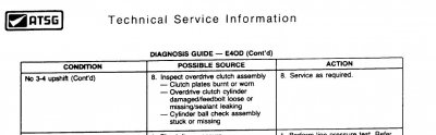

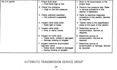

the control unit does but yes it tells the solenoid pack.SS2
here's a list for no OD.
for chip truck @ 100k miles it was reason #8 :eek:
(reman time)
