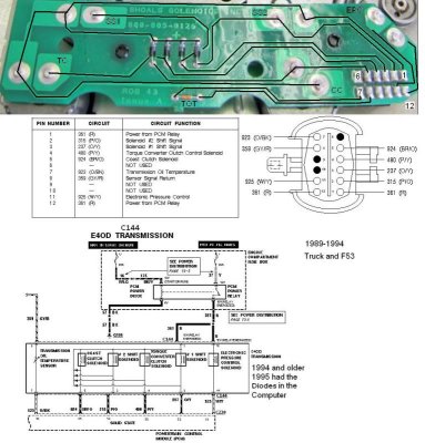

I wonder why none of those pictures ever show the solinoid or circuit boards I have looked at several on the Internet and none show the circuit board?

I just bought a new solinoid pack this morning, had a mechanic friend of mine order it,from a transmission supply shop, he uses. The box it is in says 89- 94 application, but the circuit board does not look like the one that is in my trans now. The one in my trans has a green circuit board with visible diodes and circuits and the new one has a black circuit board without visible diodes and circuits?
picture of old board, I will have to get picture of new board later.
Sent from my SAMSUNG-SM-N910A using Tapatalk

Far as color and stuff, I wouldn't worry about that. Most likely just differences in manufacturers.
Go by the spec not the color or board layout.
