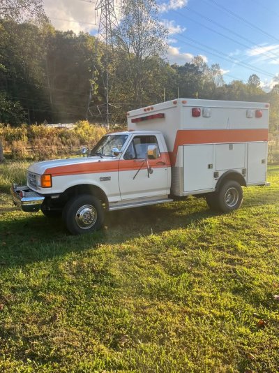

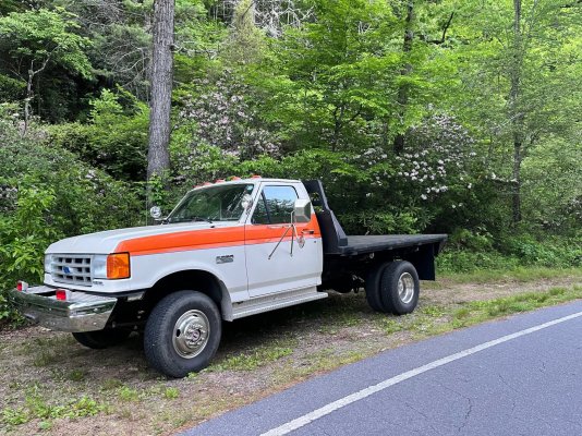

I recently had a local machine shop remove the old ambulance body from my 89 7.3 and install a flat bed, and in doing so they had to cut a lot of electric connections that travelled from the engine bay to the ambulance body and back to the cab.
The truck won’t start now without starting fluid and the transmission (e4od) is starting in 2nd gear, otherwise it is shifting fine. The tach has also stopped working. I can’t help but think they cut something that would have affected these things. Before the swap it started and drove with zero problems. any advice on where to start?
I also don’t won’t to blame the shop for doing anything wrong, but now I have a truck that is less useful than before. Do they have my responsibility here?
Before and after picture is attached.
Thanks!

Hope the shop can make you whole. The flat bed and truck look boss

The truck looks much better with the flat bed. :thumbsup:
