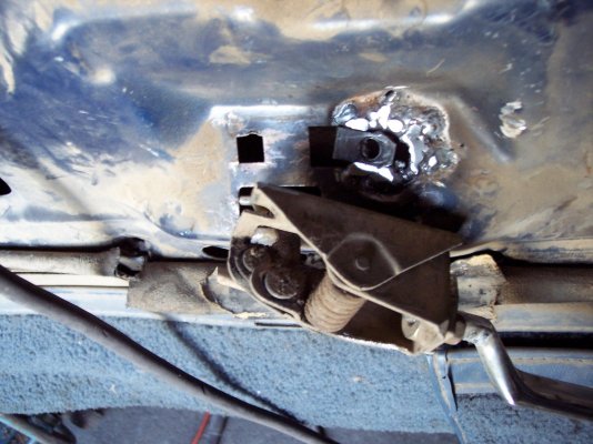

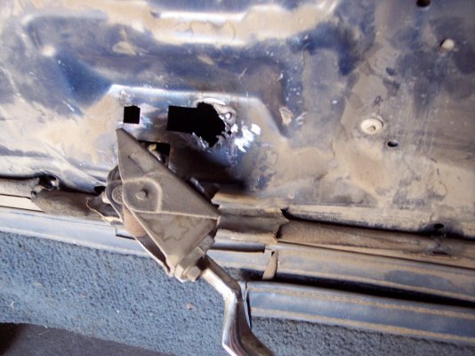

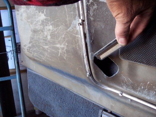

Problem, cause, solution. This actually happened last weekend, but between a big staircase being in front of the overhead door and the cold temps last week, I didn't bother taking the truck into work to fix this. The welds aren't very pretty, but it is pretty thin metal and I can't see them when the door panel is installed. It is very nice to be able to get out of the truck again without rolling down the window.
nice repair. this is such a common issue they actually make repair brackets for it, like they do for the firewall flex. so if your repair doesn't hold up you could always try a bracket, or make your own.
https://cpaddict.com/door-handle-reinforcement-plate-1980-1997-f-series-bronco/
