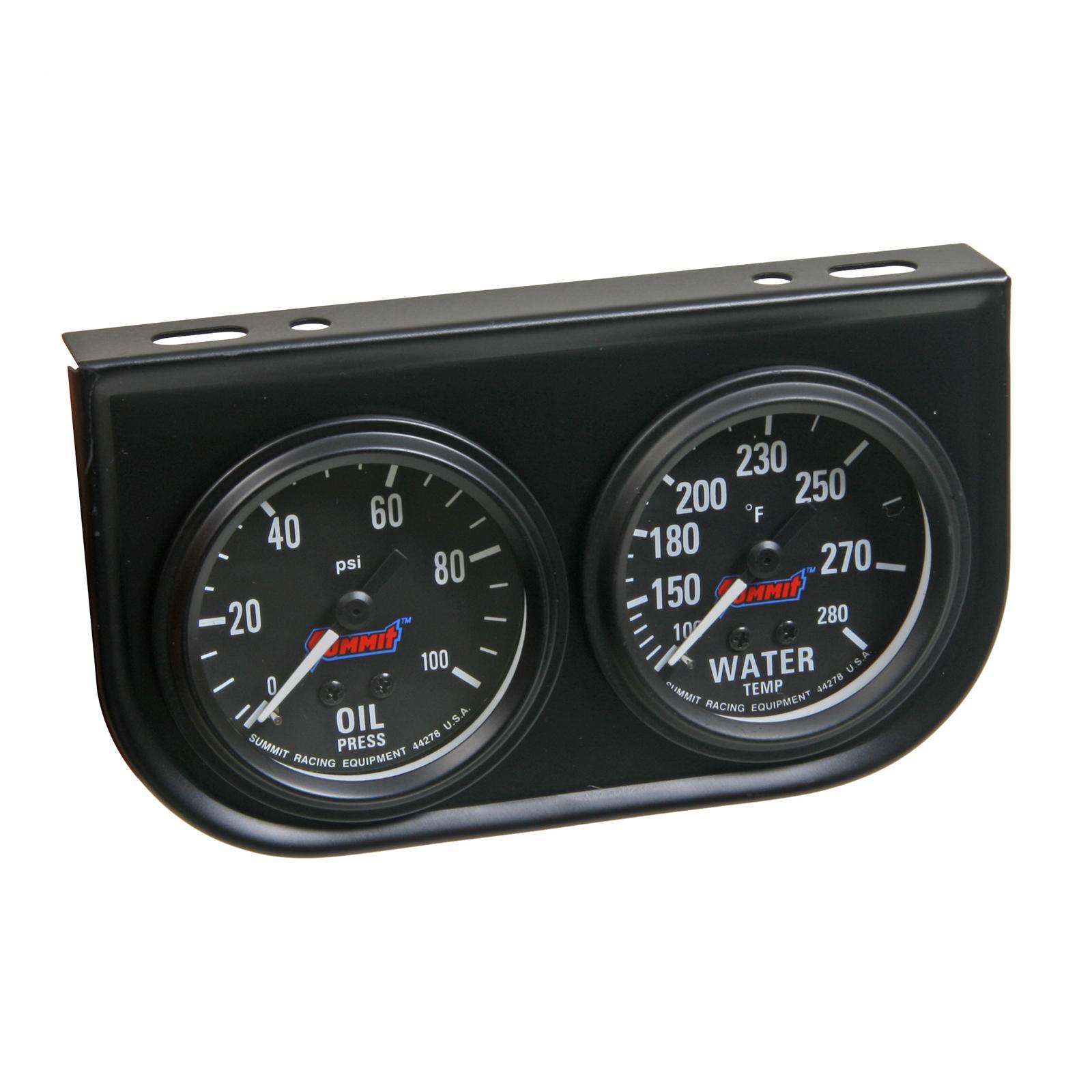

I am also considering installing these gauges, pillar gauges are cool but they are also expensive and offensively modern looking for this truck in my opinion.

As for gauges, I like my pillar gauges, but they interfere with the sun visor, which can be annoying

Yeah I did the glowshifts w/pillar and I like it. Keeps everything off to the side. And if you add it up the glowshift is probably the cheapest option if you're going for 3 gauges.
