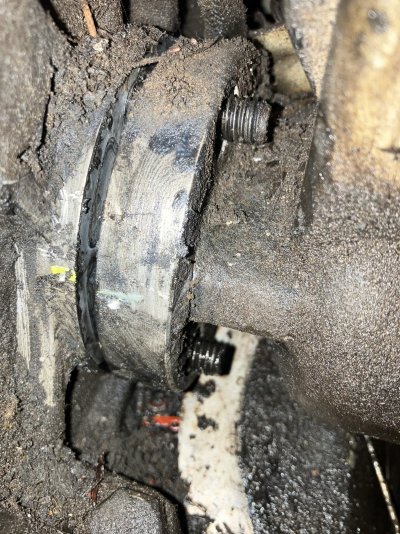

When I remove the nuts it only comes out about 3/16ths of an inch a did I miss something?

I have yet to tear into one of these engines. Does the idi have roller lifters? I just noticed the spider and dog bones in captaim720's picture.
